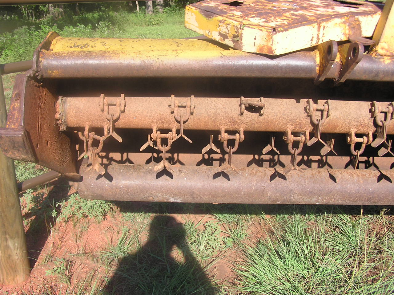

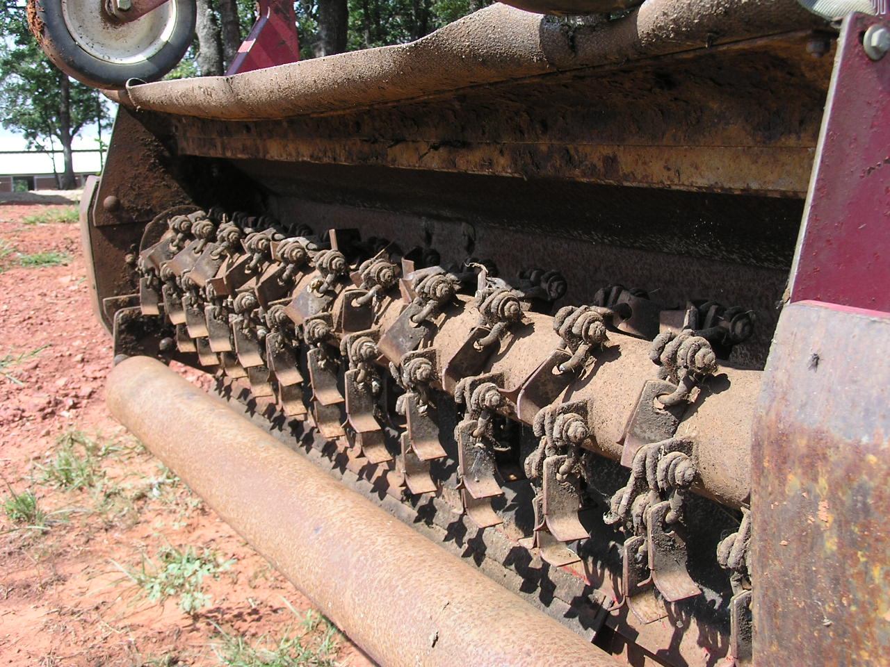

   / Front Mount Flail Mower #2
What tractor?
What is the PTO RPM and direction of rotation?
What flail mower?
Do your flail knives cut in both directions?
These knives will cut in either direction.

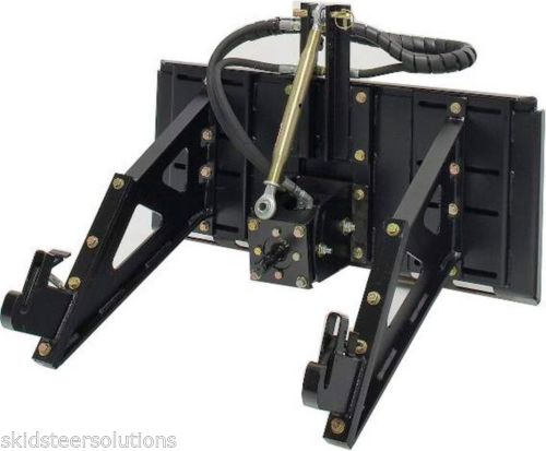

   / Front Mount Flail Mower #3
I have seen flails cut in the same direction as the tires are moving, and I have seen a reverse turn rotor, turning opposite the tractor wheels.
I have a hyd powered flail for my Power-Trac, and I can turn the rotor either way, to cut from bottom up, or top down.
So , what is the logic in cutting from the top down, slinging the cut material under the rotor, as compared to cutting from the bottom up to sling the material over the top of the rotor.
What are some of your thoughts?
If you convert that flail to hyd, you can cut either way.

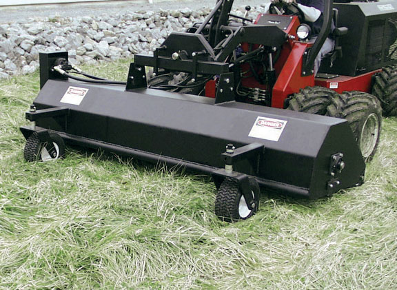

What is the problem with riding behind a flail mower, I do it all the time.
Here is a picture of my hyd flail mower.
