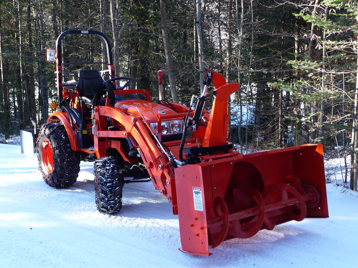

/ Front Mount Snow Blower #5
I have one on order for my NX5510, supposed to be in next week. The previous model number was SB72. The model for this year is SB74a, so it may be a different manufacturer.

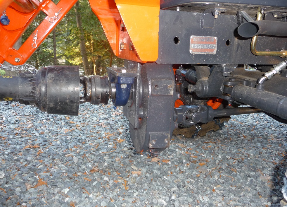

/ Front Mount Snow Blower #6
It'´s a bit of a none « regular » installation, but I found it really worth the trouble. I had to install a belly pto, front gear, modified the Martin snowblower, add a limiter on the loader Thatç—´ it (itç—´ a dealership setup/experience, of course!)
Trouble at first, but a real great set up, the pto strength compared to a hydraulic system for the ck20 is about 3 times the ability to throw the snow at a correct distance! You can attack any snow bank with ease, and twist your way around your propriety for snow clearance!
Phil

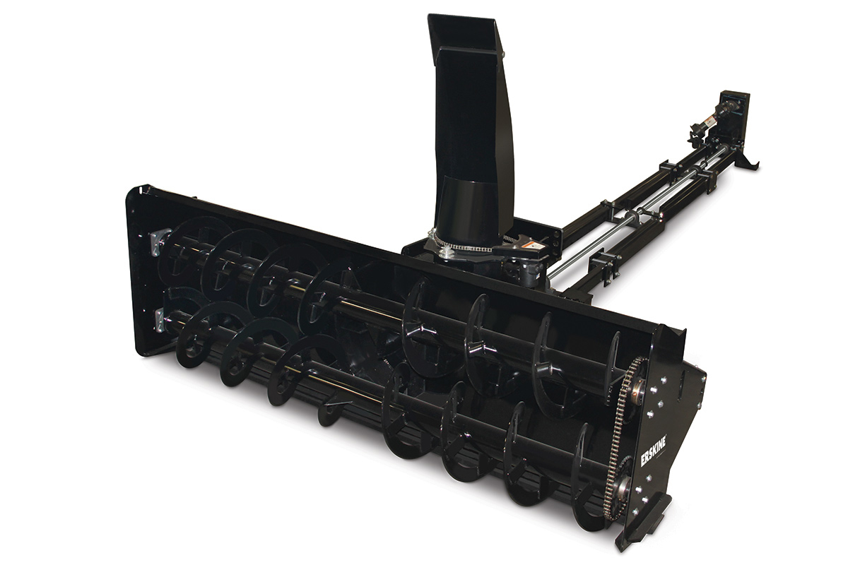

Erskine, among others, makes front blowers for many makes of tractors. It runs off your rear PTO. It is tractor independent, do not need a mid-PTO, and if you get a different tractor, you can mount it on the new one. here is a link ...
http://www.erskineattachments.com/front-mount-snowblower

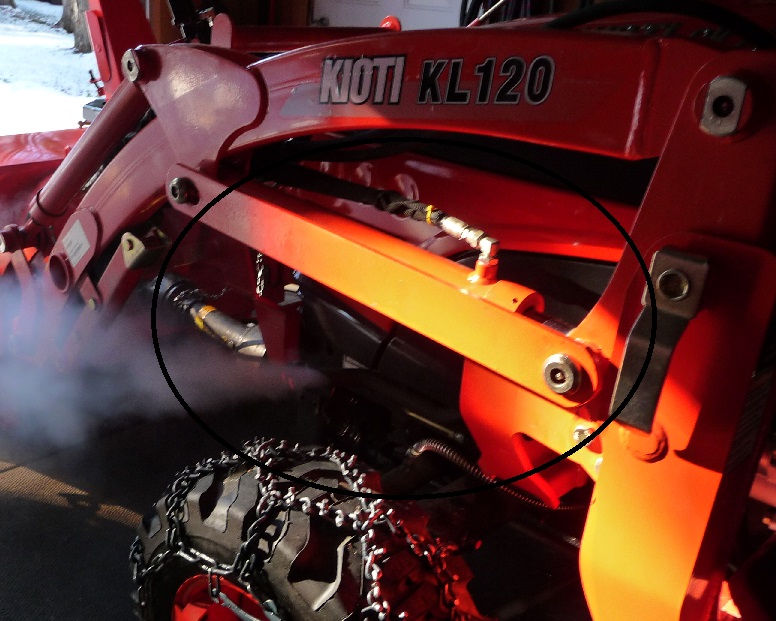

/ Front Mount Snow Blower #11
Updating my prior post. The old model was SB72, this years model is KS74-240FM. The manual that came with mine has a 8/2018 date stamp.
Kioti branding, but appears to be made by a Canadian company named Normand (Compagnie Normand | La performance attachee a vos tracteurs). Seems to be very nicely made. Runs from MM PTO, and the standard FEL hydraulics. Besides the special subframe, if you have a MM PTO, no additional mod necessary.
While loading on my trailer, we noticed the clearance between the hydraulic fitting and the SB was very tight, so we reversed the orientation of the hydraulic piston. If loading flat, or maybe onto a dovetail trailer, this is probably not necessary.
We haven't had as much snow this year as I had planned for, but here is a quick video. The 4 inches I was clearing is probably a pointless amount of snow to throw, but I wanted to try it out. It's not in this video, but the SB effortlessly took out a few plowed piles that were the height of the unit. Will post again once we get some deeper snow.
