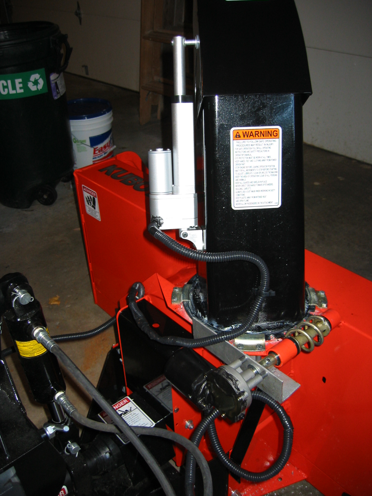

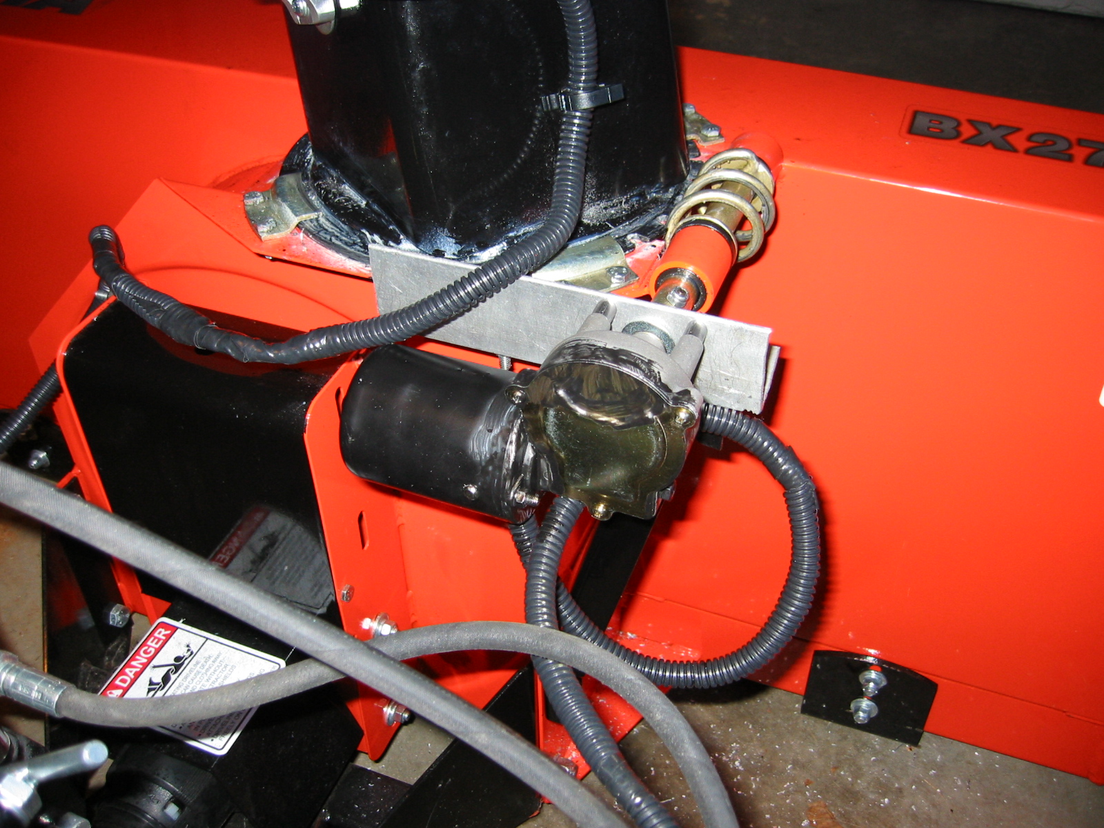

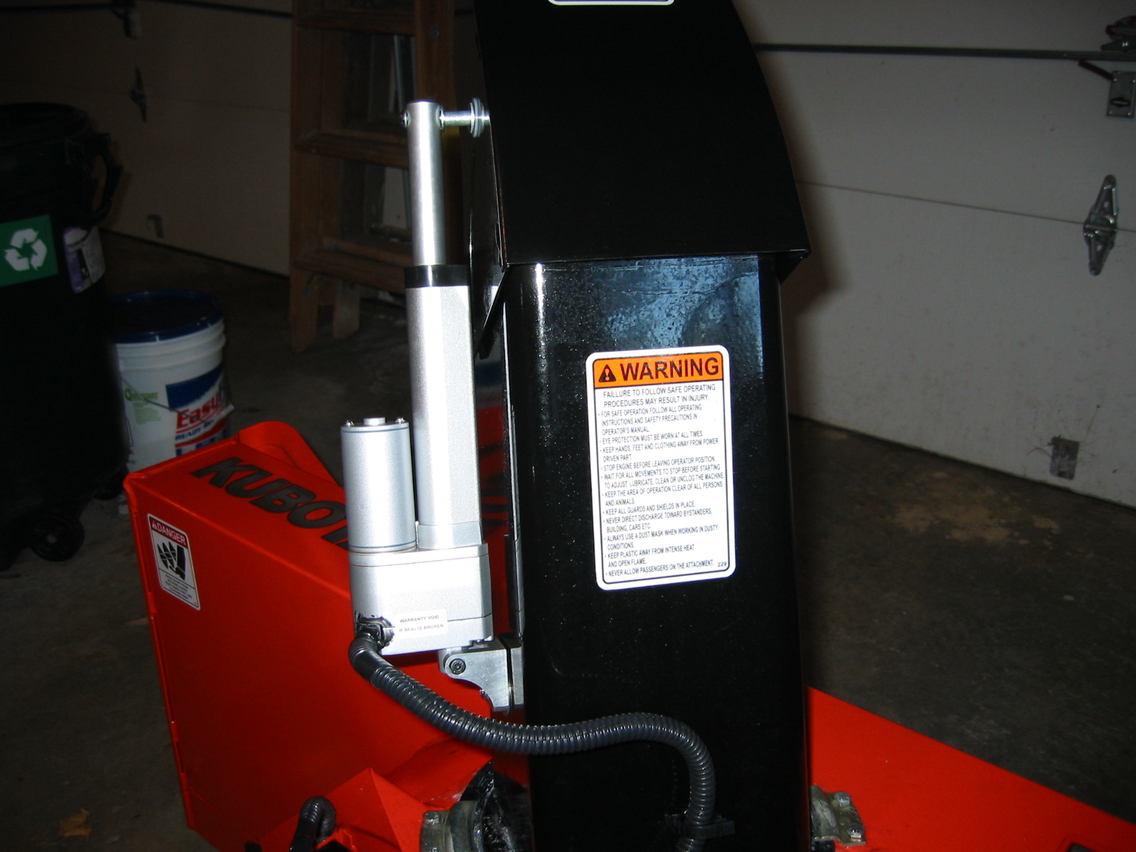

I'm still waiting to try mine out here in Massachusetts.I got it a few months ago and did some modifications to it with an electric chute rotator and chute deflector.
   / front mount snowblower on the kubota
#9
I have a hand crank for the rotator but i would love to move the chute deflector up and down. How did you do yours??
   / front mount snowblower on the kubota #10
I bought the actuator for the chute deflector online from surpluscenter.com.t's a 3.93 stroke,part#5-1577-4 and the bracket for it is part#5-1577-B and a DPDT center open momentary 20 amp toggle switch.The total with shipping was $102 and it's real easy to install.
