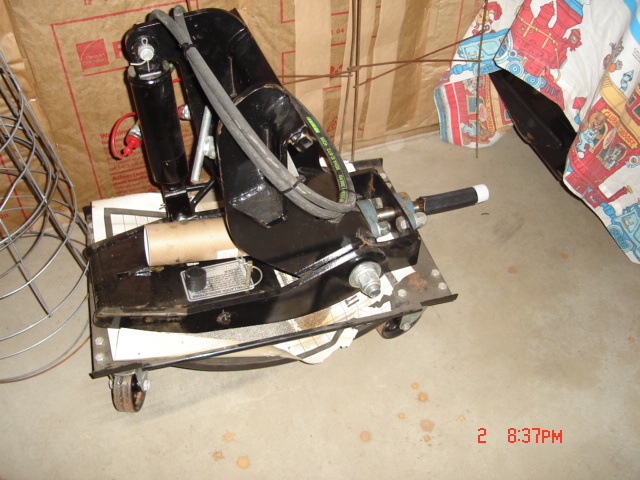

   / Front mount snowblowers - MF 1410 vs 2360. #6
When I ordered my tractor (GC2310) a year ago, I got it with the 2360 blower. At that time, the additional $$ was around 3900, which surprised me, until I saw what was involved. In addition to the blower, there's a "quick-hitch assembly" that mounts to the front of the frame, after the grille guard's removed. The 2360 is 50" wide and seems well adapted to the 2310's power.
Then there's a driveshaft extension that goes forward from the mid-PTO, as you suspected, that connects to the rear of the quick-hitch. The price included electric chute controls and installation by the dealer, which is somewhat time-consuming, but fairly straightforward mechanically. The quick-hitch business is just that; it makes installation/removal of the blower quite easy.
Sounds like the prices have gone up a fair amount. I don't regret it one bit, however, as it works very well.
