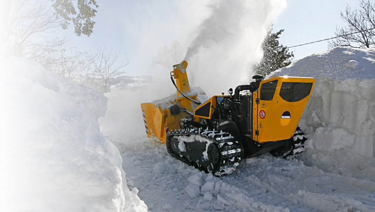

Hello and good morning Mr. Stevens,
I am glad we clarified things yesterday with regard to the Series 1000 units not being commercial units.
I have add three pictures of the Riest Series 1000 unit as a hydraulic drive unit mounted on a bobcat for you to examine.
They can be ordered with a wider cut also.
A change order for 2 more lifting paddles can be done also allowing the center paddles to discharge snow at a much faster speed.
The track drive snow thrower in the uploaded image is a single stage snow thrower mounted on a track drive remote control unit- being one of my future toys I hope.
Hoping for snow:cool2:
