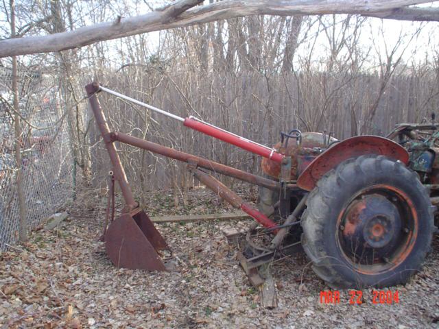

Anyone have a FEL mounted backhoe? I have never seen one and I am interested in user/observer comments.
Are they useful or frustrating?

The only front mounted BHs I have seen are on bob-cats. I have also seen an extended arm with a hydraulic bucket that uses the FEL dump to angle the arm. Something like that would be fairly easy to make for a CUT. I see two problems one is visability, the other digging force with the curl cylinder.

I see a third problem. Dumping what you just dug up. A backhoe lets you swing to the side to dump the bucket. You would have to move the tractor after each dig.

I was trying to remember where I'd posted that link, but you found it anyway/forums/images/graemlins/grin.gif. The Struck Dozer Page used /forums/images/graemlins/confused.gif /forums/images/graemlins/mad.gif to have info on their versions and a movie but they don't seem to be there anymore. They had one fixed one, and another that swang to the side. There's pictures of the BH50 (fixed one) that I just found in the pdf brochure .
I'm not much of a fan of CADplans, but they have plans for a Skid Steer Hoe too.
I was thinking of making something like this, but in the end I designed and built a backhoe attachment.
Attached is a picture of a real simple backhoe that someone made (I guess) using pipe. It has a fixed bucket (no curl). I figure you could make something like this pretty easily that could attach to a bucket (or instead of a bucket).
I've seen another one too, but can't bring it to mind right now. Sorry. HTH. Andrew.
