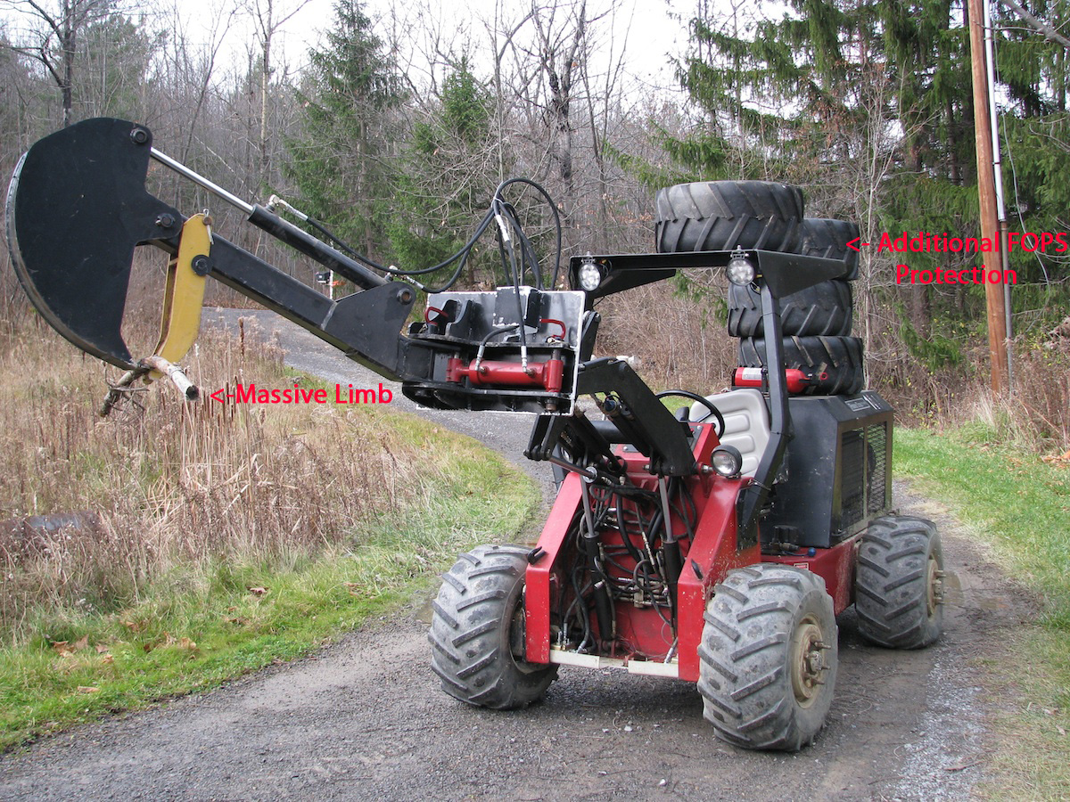

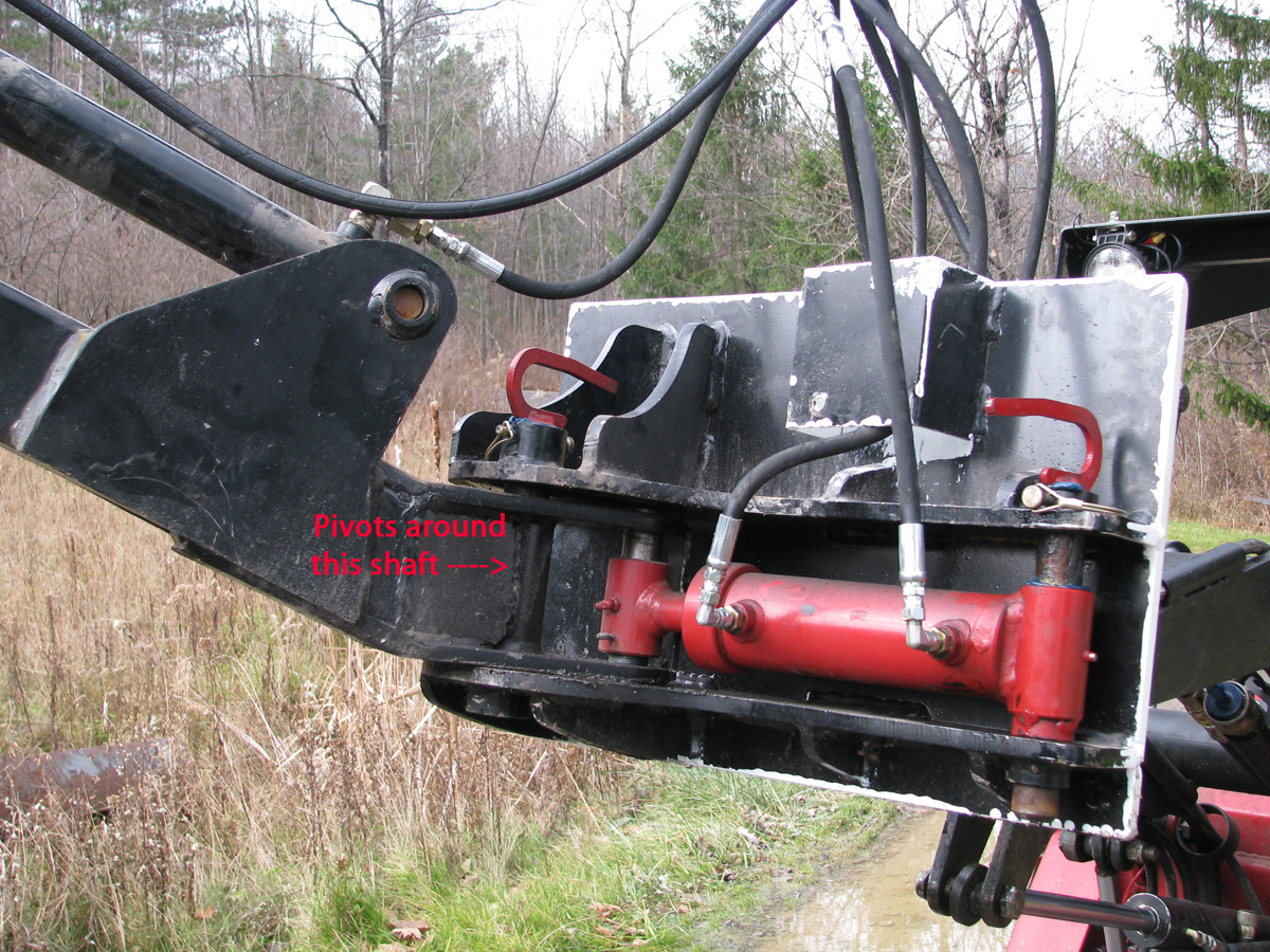

Thought some of you might consider a front mounted BH, something like this. Owned by SpringHollow on?TBN.
One cyl swings about 60 degrees. Any questions refer to SpringHollow on TBN

That's pretty nifty. He did a great Job on it too. :thumbsup:
Chad
   / Front mounted BH #3
I have thought of doing something similar but I wonder about visibility, since I have a conventional tractor, it would be pretty hard to see over the hood and into the hole.
