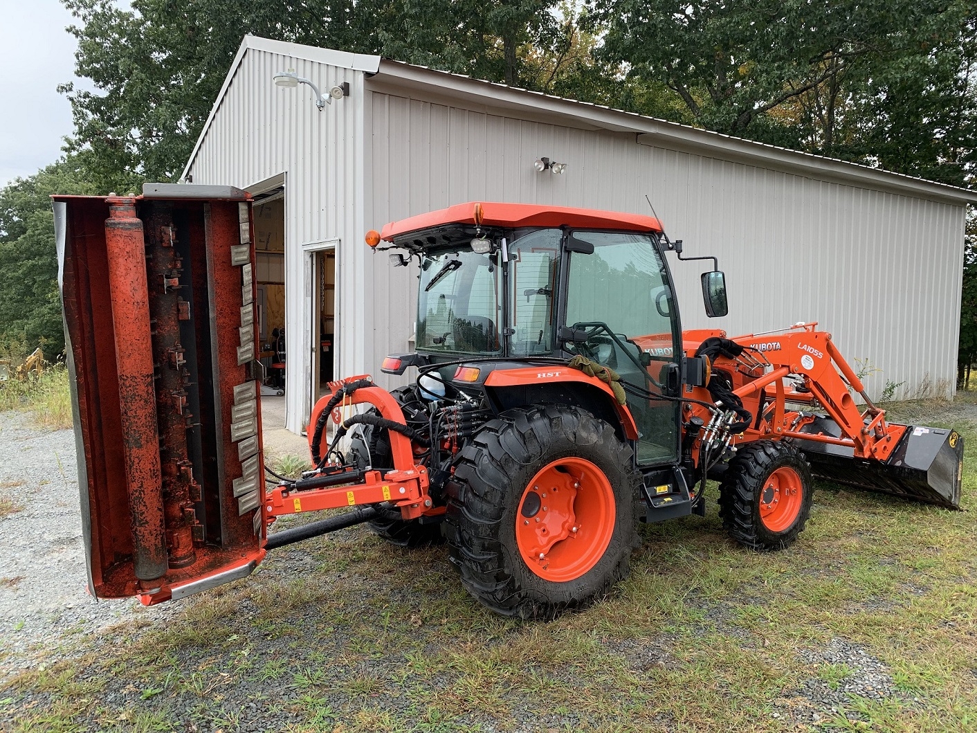

Not quite the same, but I gave up using the offset articulating flail on my open station MX5800. Even with helmet, face shield and heavy clothing, I didn't feel safe. I got hit with too much debris that bounced off trees, rocks and the ground.
Even the cab of the L6060 gets pelted. Haven't broken any glass yet though:
Might be different with a front mounted implement though.

Does your flail mower discharge towards your L6060 or away from it?
Front rotary cutters have some advantages, but the amount of loose material and dust that comes back at the tractor and the operator is their disadvantage in my experience.
Some protection will be offered by having the pretty big front end of the MX5200 between the operator and the brush cutter when the cutter is run at ground level, but I'd still wear face protection.
My front cutter throws so much out the rear that I welded a piece of metal over the rear discharge. That reduced the amount of discharge from the rear. Most gets discharged from the front now. But I still wear face protection.

The flail discharges to the bottom and rear when horizontal and to the left when vertical. In both positions, debris is thrown away from the cab but often ricochets off nearby fixed objects.

Yes, definitely a ricochet on the neighbor. I haven’t noticed any issues with the flail. Is yours all the time or when lifted off the skids/roller?

With the roller on the ground, the deflectors keep flying debris to a minimum. The hammer flails occasionally throw a rock though.
