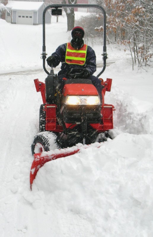

I'm also from CT, have the BX23 with the hydraulic front blade (BX2763), and the quick hitch (BX2751). I plow a 450' processed stone drive that has a moderate incline in parts. I have loaded turfs on the rear, and in the winter I put loaded bars on the front to help with side slipping. Traction is surprisingly good. This setup does an excellent job, and I would recommend it. Get yourself a good set of insulated coveralls, good boots & gloves or mittens and maybe a ski mask, and you'll be moving snow with a smile on your face:D.
The attached pic is before I switched to the front bar tires.

Ken CT:
I know that you are smiling behind that ski mask :D!- Jay
