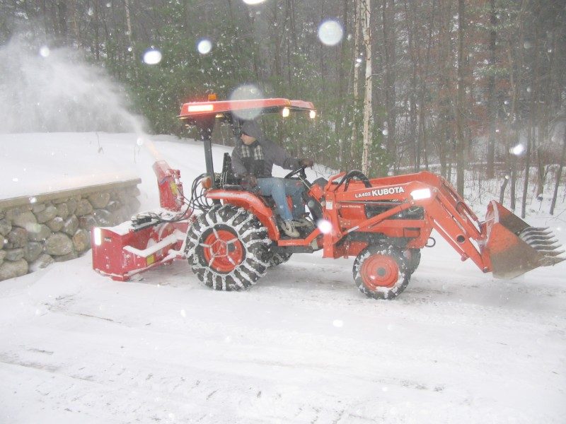

Of course I don't need a cab, I have kids who will do the work for me. /forums/images/graemlins/grin.gif /forums/images/graemlins/grin.gif

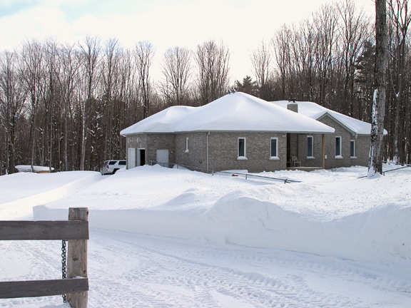

""The negative to plowing is as the winter goes on, your driveway narrows with each snow fall - you're not left with anywhere to push the snow. Also, traction can be a problem if your pushing alot of wet, heavy snow, specially up any kind of incline."" KubotaOne
This hasn't been a negative for me, nor a real situation. I bank all the snow to one side of the 600' drive (that is 12' wide) on the downwind side, and if it gets up to 3' high, I cut that bank off with the blade raised about 6-8" high. This moves the bank back where I have plenty of room, i.e. no buildings or fence to be pushing against. On the occasion this gets too high, then just pushing the bank straight back with the blade straight works very well too. In a real big storm, I can drop the plow off and quickly put the FEL with bucket on to carry the snow away. Now, it has been 3 years since I have had to even think about the FEL, but I'm ready. I put on chains only when the drive is ice covered (happened once last year with a heavy rain and freezing on.

I agree with your comments, and you're right there are ways to control the "narrowing" effect. Plowing can be the best alternative for some. We are located in ski country, dead center of the snowbelt, and it's not unusual for us to get a foot of snow a week. Add a few mild spells and then a cold snap and those banks get awfully hard real quick. I really think the decision should be based on drive layout and the amount of snow you get. <font color="red">

Having tried a rear blade and the FEL for snow removal while my front blower was on order, I can see no useful reason to need an FEL in the winter unless you are cleaning a barn or other "farm" type chores with it. The front blower does everything the FEL can do with the snow only faster and better.
The "moving snow banks" argument doesn't hold water either. If you have the front mount blower (or rear mount) you won't have much for snowbanks because the blower will move the snow further away then just the edge. Also a properly adjusted snowblower will not need the FEL to return to scrape up the leftovers, it will have done it all the first time.
Yes, front snowblowers are expensive. But when it is all said and done the are the most efficient, fastest and ergonomic way to remove snow with a tractor.
