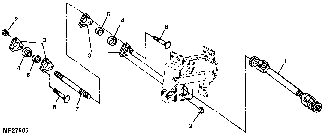

Defed if you need an front idle shaft G & G manuf. has 1" 15 spline on both ends and 12" long. Should be about $40, Deere uses two different 9" shafts at $90 and $140. Hydraulic shops might have this also.
If you can mount the shaft towards the mid pto side of the tractor you can reduce your true operating angle. Mine is at 8.6 degrees -just in spec- using the original configuration. This will impact the front shaft of course but it's only 16" long
