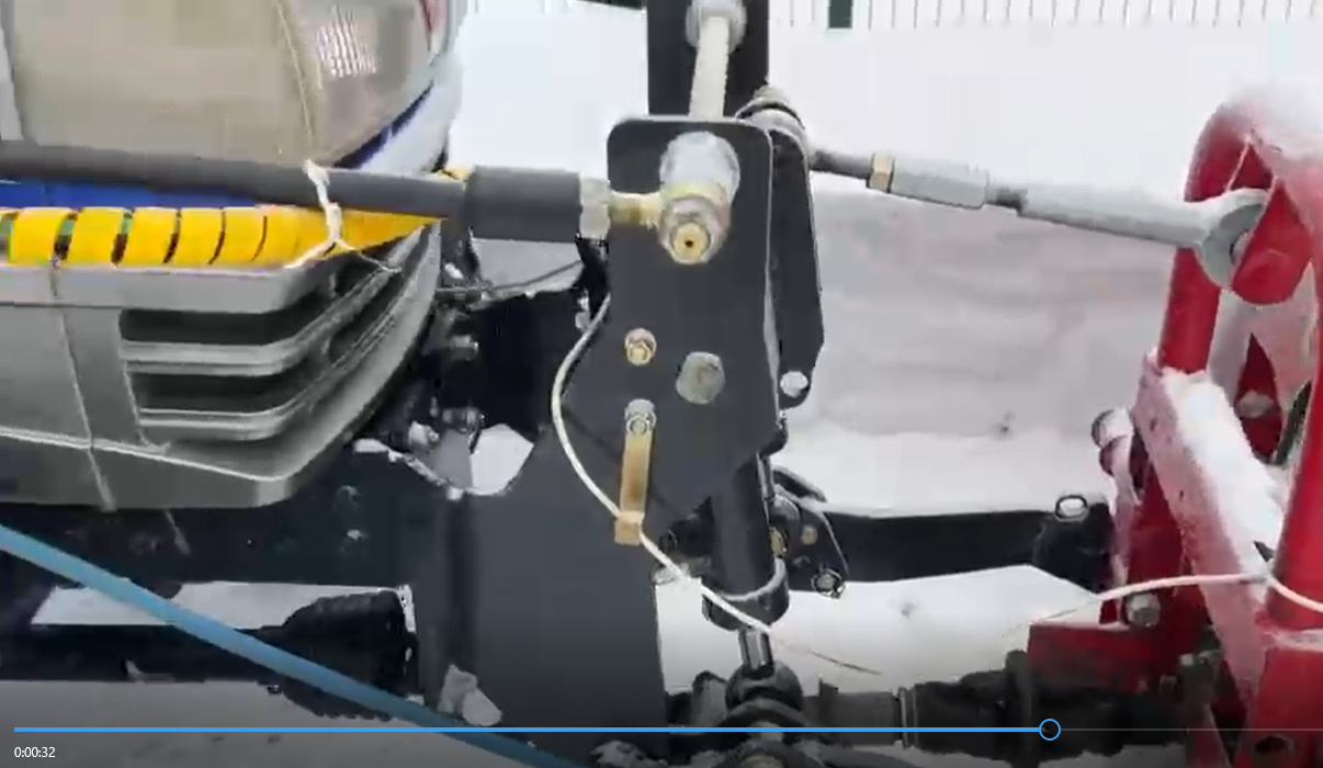

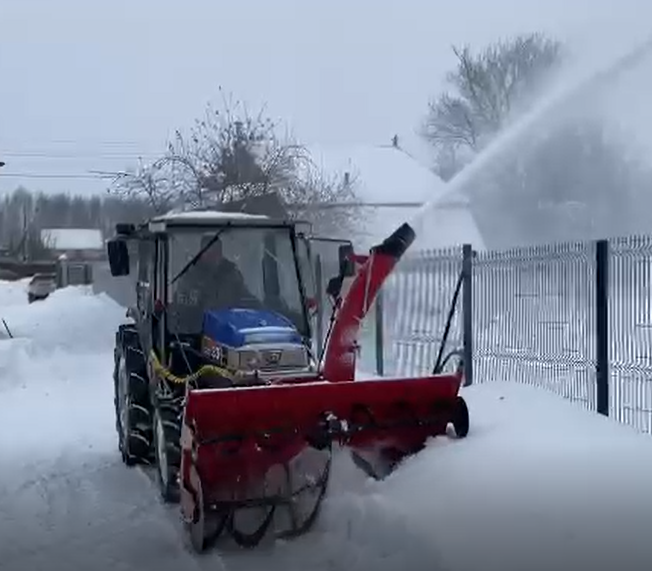

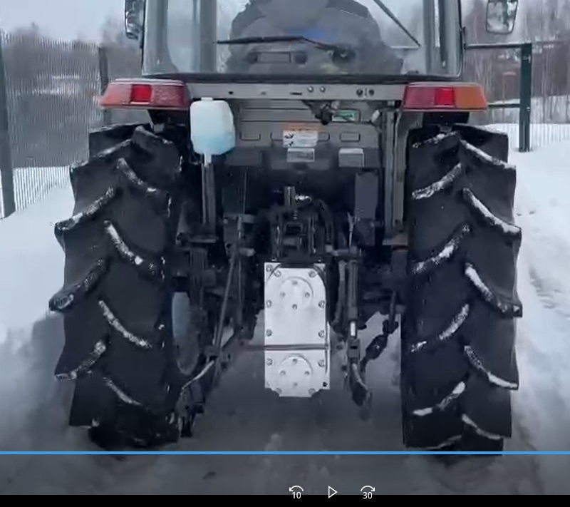

That gearbox sending the PTO to the front is working great for him. His snow blower must use most of the tractor's hp, and its working flawlessly.
   / Front PTO YM240d #16
Thanks! All better now.
I'm amazed how quiet it runs. In the vid the auger hits something like a stone and the noise is much louder. Everything is meshed together like an OE setup.
All I did was share a Yanmar manual with him for the idea of the gearbox. He and a few others did the calculations and completed the task. He did send me the SolidWorks CAD files too.

Those YT vids do show much more of how the rear to front PTO setup was done.
