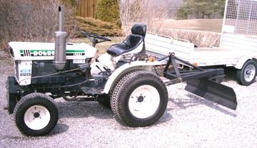

There are factory front PTO's out there. I have one for my Iseki, made for the Bolens models. Haven't mounted it yet, but I attached a photo of a Bolens tractor with one installed.
These Bolens models are no longer made but front PTO kits must be out there for other CUT's.
Bill
