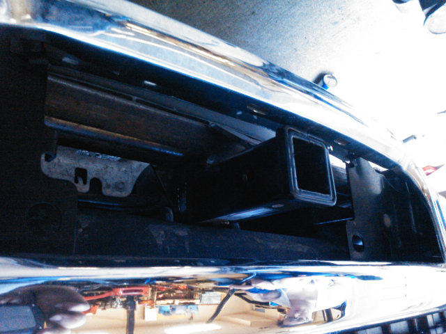

I'd check into getting the side license plate mount for the Ecoboost models, either new or from a salvage yard. That would give you the full center opening to work with.

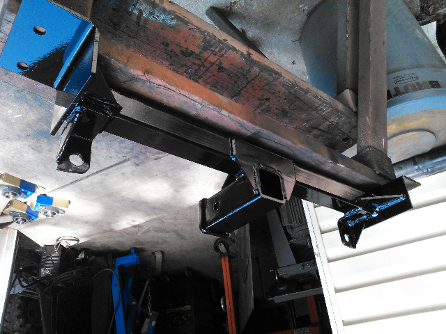

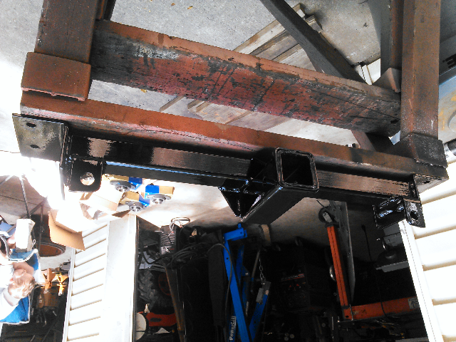

Sorry they are upside down, have to work off my phone right now. It bolts in using existing holes and doesn't require the removal of the bumper. For the license plate holder I just made a simple plate that pinned into the receiver when not in use. The guy I built this for uses it to mount a large cooler and fishing gear.

TMGT, nice job. What are the two large holes on the pictures? (Not the ones that bolt to where the tow hooks go). Are they for an additional mounting point / bolts?
Yes the larger holes are extra mounts, I believe they tied into two of the bumper mounts. They are oversized to allow for alignment, I'll try to look for my drawing/ notes on it tonight or tomorrow.
