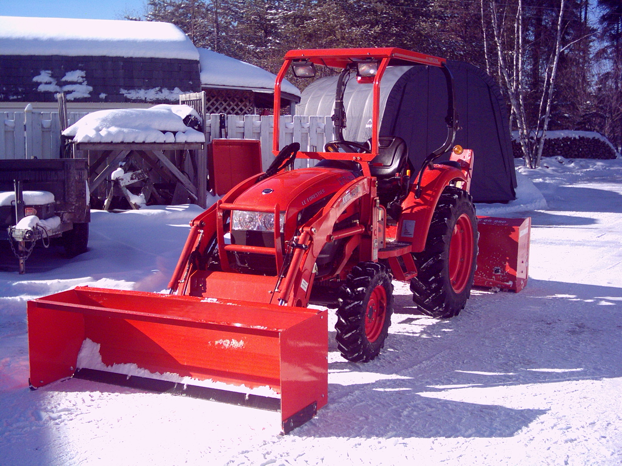

I have a front blower on my 17hp kubota and does a good job but now i also have my CK30 HST and would like to use it, Im thinkin a box blade that quick tatches . I,m going to make my self. Anyone have one Size and pics would help.

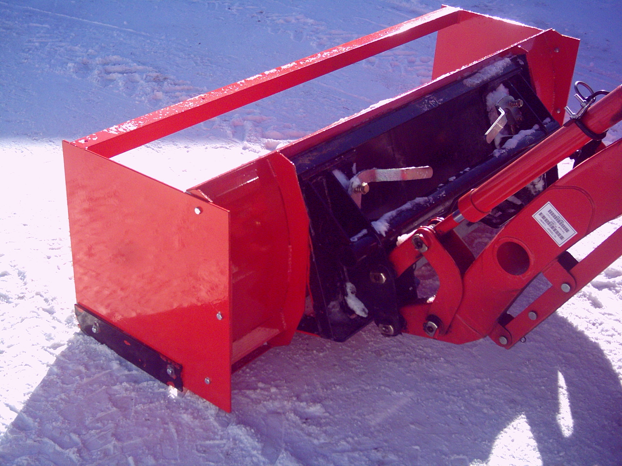

Here is one i have made myself, it's a push/pull type with a skid-steer attache. The blade is 66'' wide and 22'' high. The side-plates are 21x21 1/4 thick. All this cost around 300$cnd to build.

Thanks you did a very nice job:thumbsup:
Did you roll the back or just brake it?
what did you use for the blade edge?
I was thinkin of making mine so it could float in case one side needs to
be higher as my ground is rolling and uneven?
Its alot more work though.
HB

Thanks, glad you like it. I did brake the blade, had to do with the tools i have. The sides have floating shoes, and i used T-1 steel for the cutting edges and side shoes. This is the 2nd snowplow i make, so next time it will be even better, probably add a trip edge.;)
