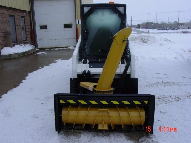

Hi. Are there any front mount alternative blowers that fit the BX25D Tractor?
Thx

Hello Daveee,
Check with the folks at Riest industries in Elmira, Ontario. Their Series 1000 single stage mechanical drive snow thrower should fit the bill nicely.
It is rated for mules with 15 to 25 horsepower and It can be front mounted with their front mount hydraulic lift kits.
They have all the parts you need for both front and rear mounts.
The picture I uploaded shows a series 1000 mounted on a Melroe Bobcat but you can also mount them on the rear three point hitch of your mule to use the 540 RPM power take off.
The rotor/auger speed can be changed/increased or decreased by changing the sprocket sizes which is easily done by the end user with simple hand tools and a torque wrench and blue loctite.
