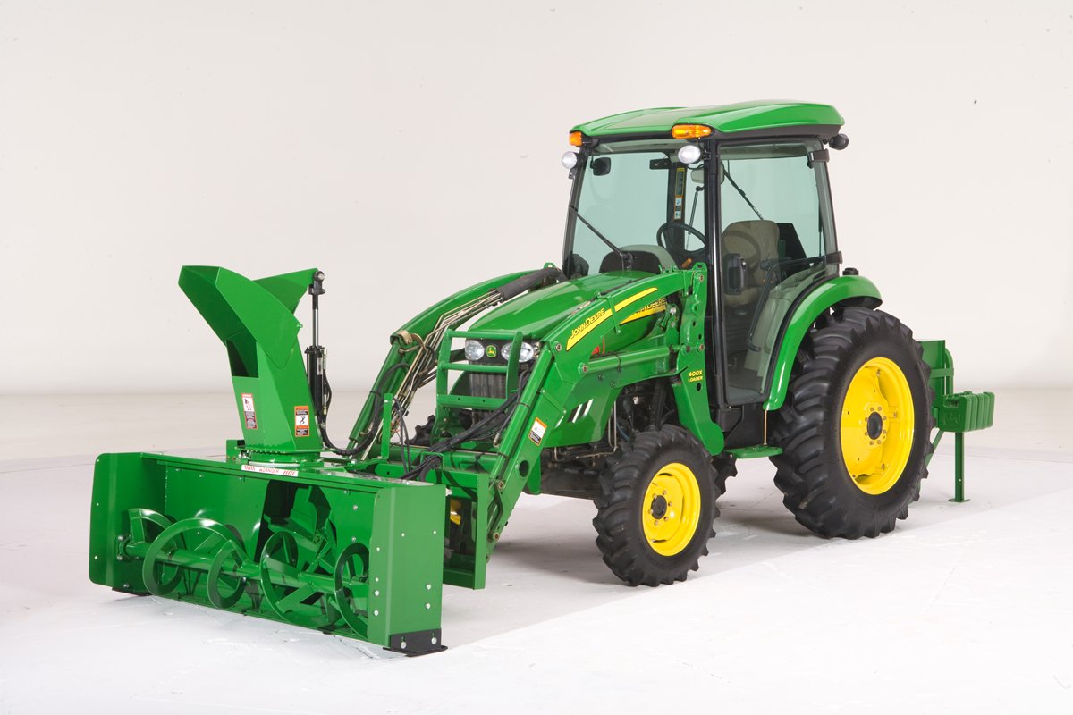

John Deere makes the SB2176 if you have $13K to spend on it.

I helped mount an Erskine snowblower on a Deere. The owner was making the move to front mount because he found it too dicey blowing off his drive driving backwards with his rear mount. The front wheels would too often go "over the edge", according to him.
He was very happy with the front blower for the mile long drive. Said it was well worth the price, and he didn't have to be turned in the seat looking back.

Get one from JD. They are built by Rad technoligies in Quebec, and are driven by a mid - PTO.
