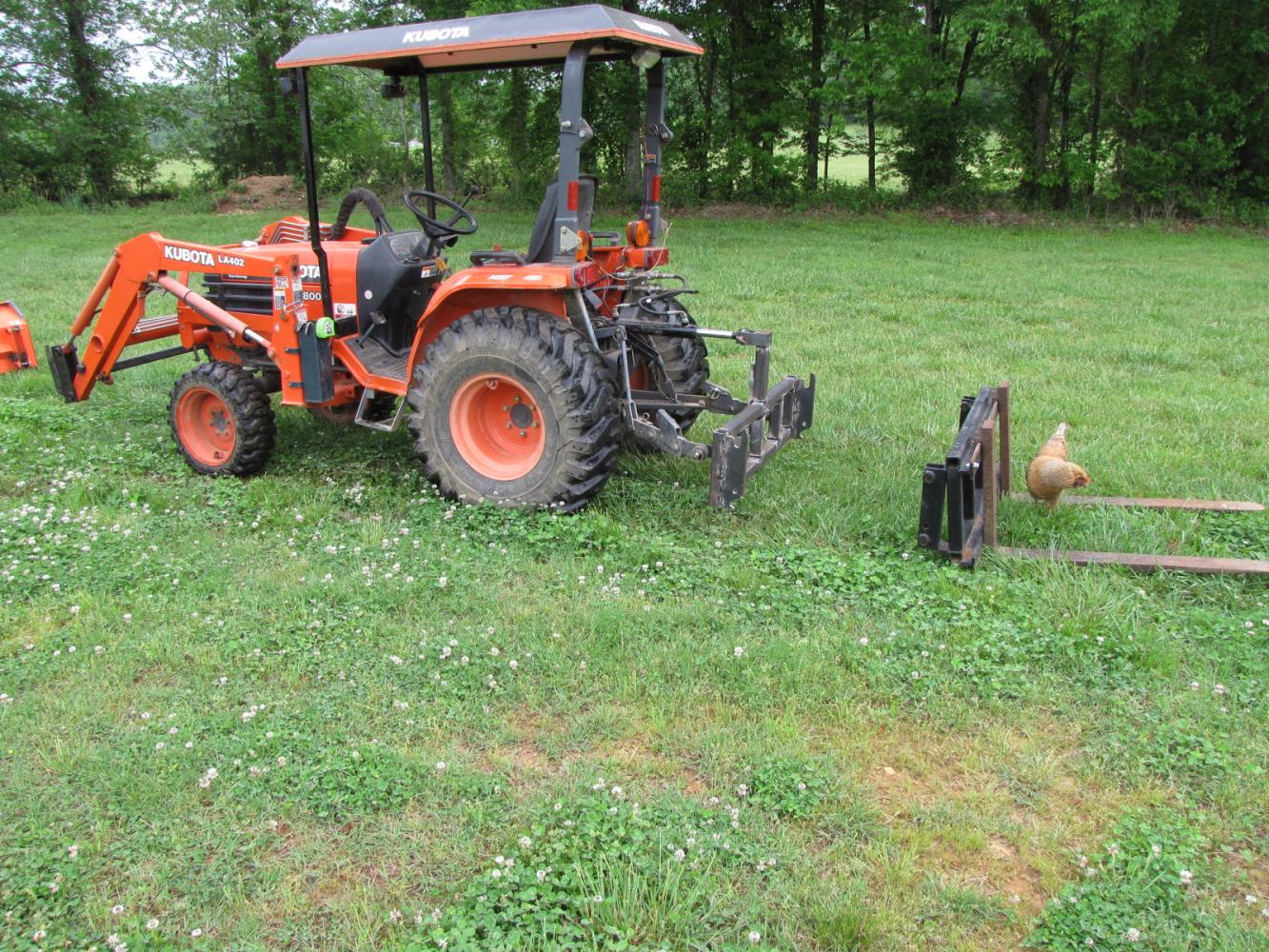

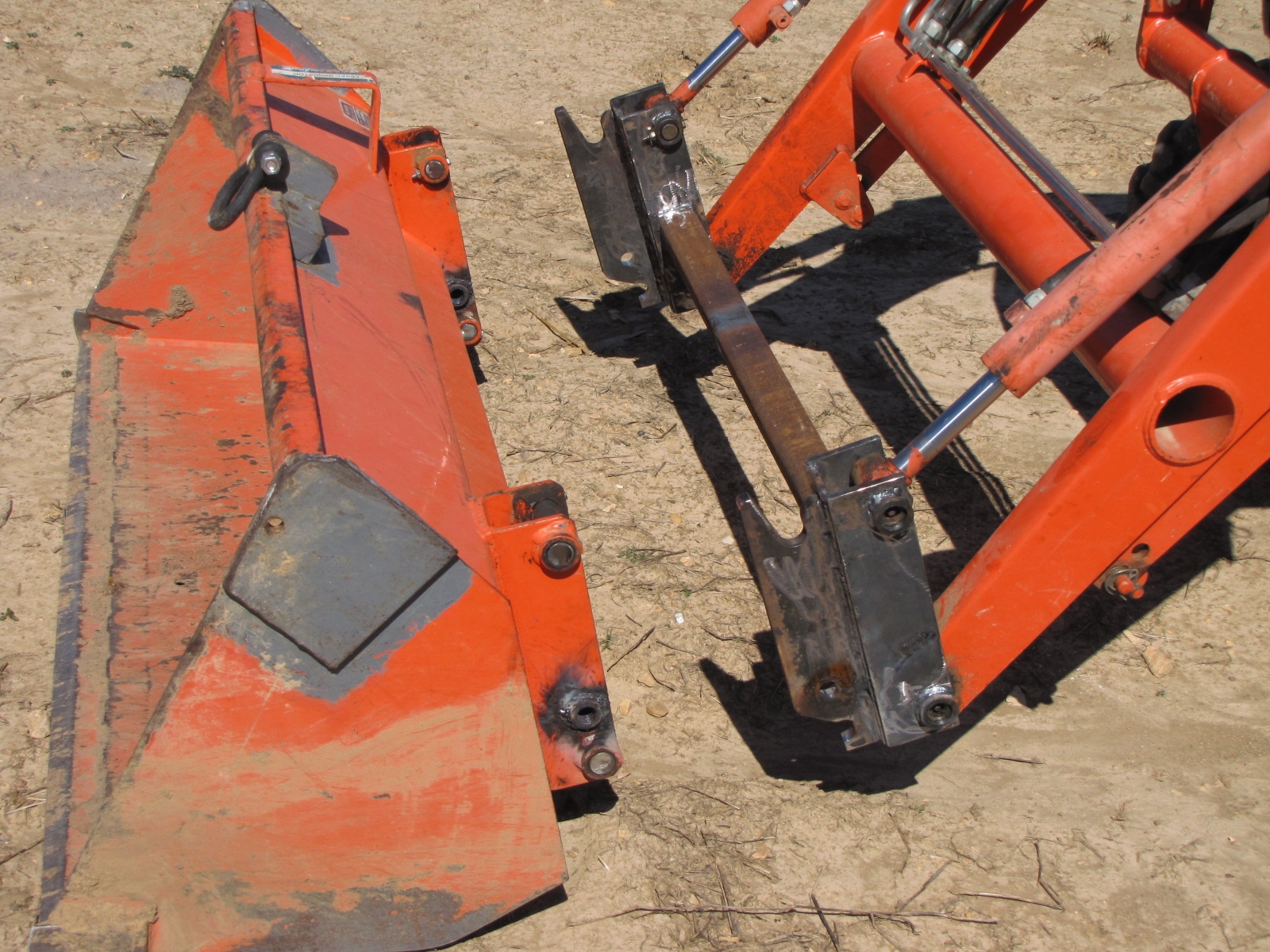

Leejohn, that's exactly what I had in mind. Can you show a close up of that rear setup? It looks like a pin on to SSQA plate modified for three point?
I figured I could use the pallet forks to carry a carryall box/ballast etc that way when the bucket or grapple is on front and the bucket when the forks are being used.
!st off they don't make a SSQA for my B7800, so I came up with this. I must say I like it better then the one that came with my L4240. If I can find the time I'm going make some hyd cyls for the pins to hook and unhook it.
The frame I made for the 3 pt started out as a hiller and planter, then I made another set of brackets for the bucket. I also can use the forks on the back without the frame set up.

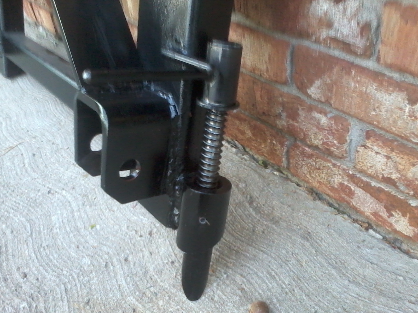

http://www.tractorbynet.com/forums/customization/321704-linear-actuator-power-ssqa.html
My power SSQA build... You could easily get by with the cheap $60 actuator on a B. I expect & it would lighter than hydraulics cutting into your lift capacity less. Its a little slow, but in using mine I've found actuation speed is less important than I originally thought in real world use. Easy to anticipate 10-15 seconds out or more before you are going to dump an implement. And you just throw the switch & drive off without waiting for the pins when picking up an implement.
Not sure if you are talking about front or rear, not that it changes the conversation much.
   / Front SSQA & 3pt pallet fork attachment??? #14
I have some actuators and I just don't have the room to use one. The hyd cyls I'm making are small and well not take much from my lifting power. I was watching your thread when you were posting it, it's a good ideal and would work on my L4240.

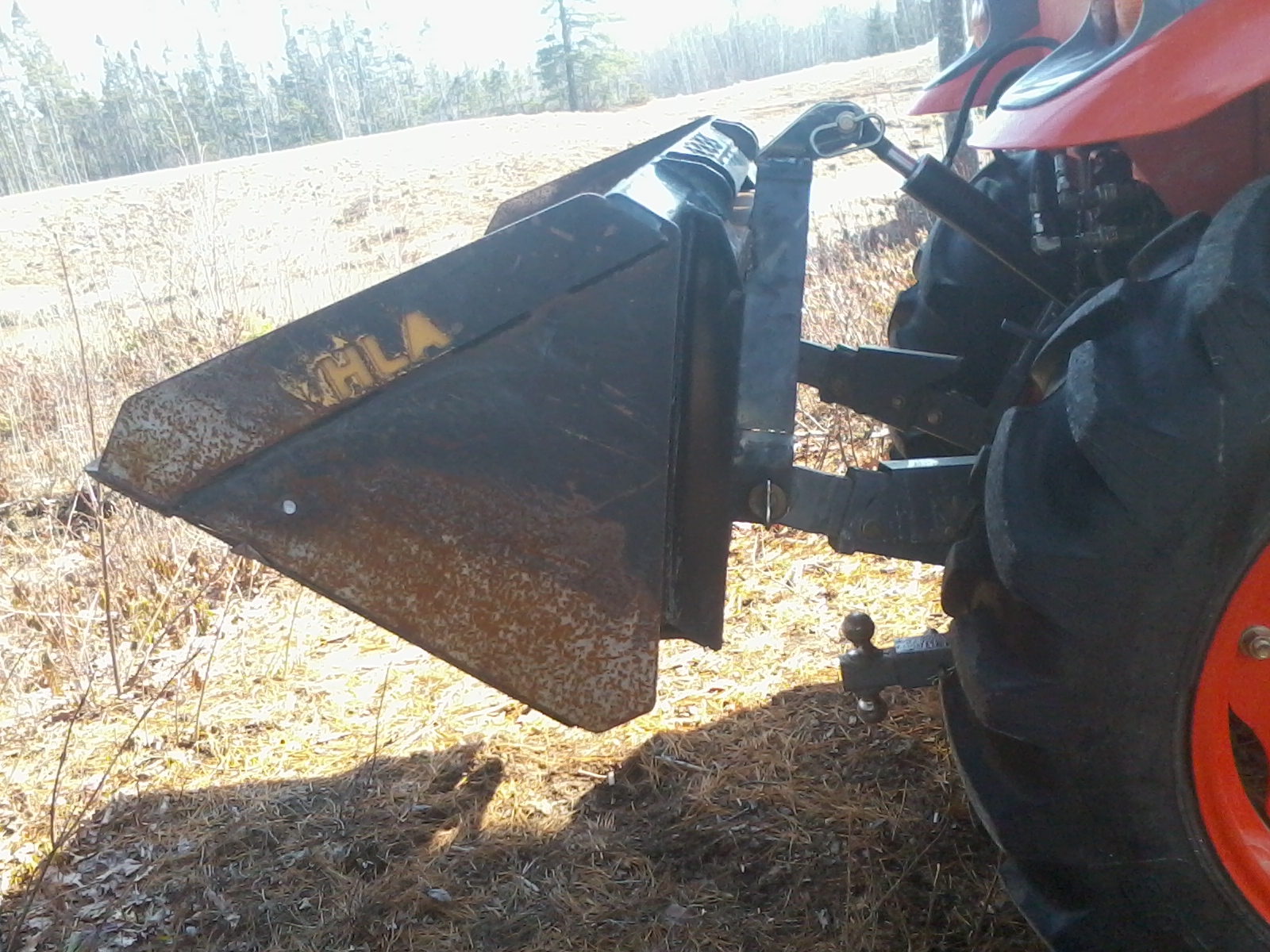

I built this from scrap metal and never used it yet. Just thought I needed it I guess. Hope it helps.
Steve

Steve, where do I need to come pick that up since you don't use it! <laughing>
That's exactly what I was thinking of.
Lenny
