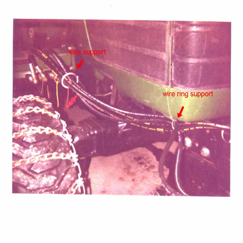

Are your front wheels reversed, possibly positioning them closer to the cabling bundle?

I had the same problem with the FEL on my JD 4200. When I first mounted my JD 59"snowblower it had two fittings that mounted to the frame without drilling and kept the snowblower hoses off the wheels. I just left the fittings in place when I removed the snowblower and routed the FEL hoses through the fittings. They are called a"wire support hanger" and a "wire ring support hanger" for the 59" snowblower. I am sure that they can be separately ordered from your JD dealer.

Both fronts and rears can be turned for either a wide or narrow stance. Mine have been in wide mode since day one. I really believe the JD set-up just doesn't provide proper restaint to keep the hoses out of the way.
Bill,
Can you post pictures of the snowblower support hangers you use?

I will try. This is my first attachment and I do not have a digital camera. I took a Polaroid and scanned it. The forward support is the "wire ring support hanger" and it is free to rotate. The after support is the "wire support hanger". It is fixed.
