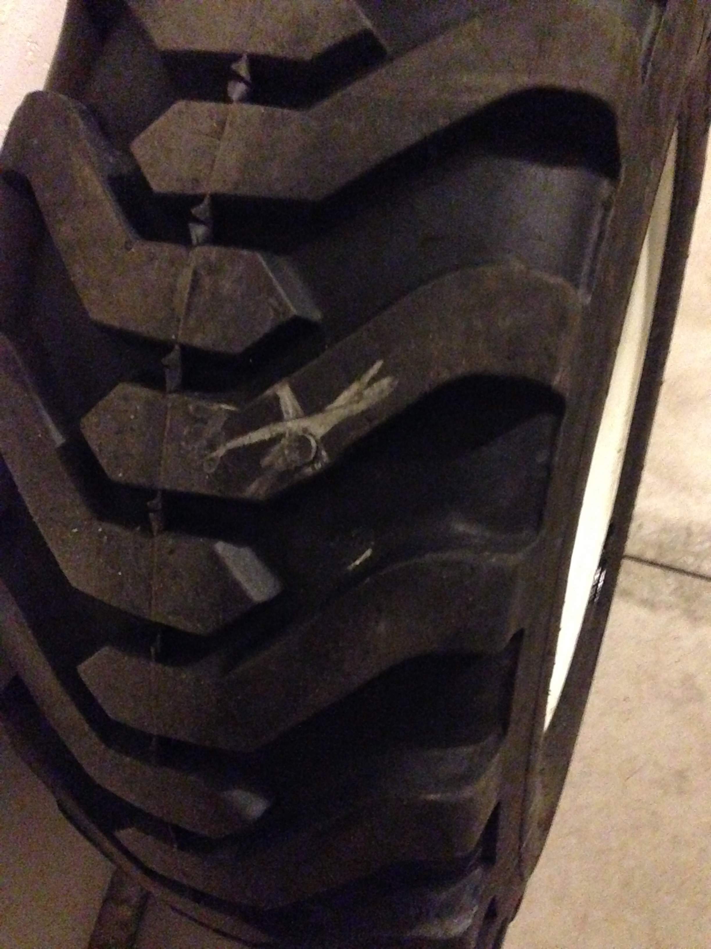

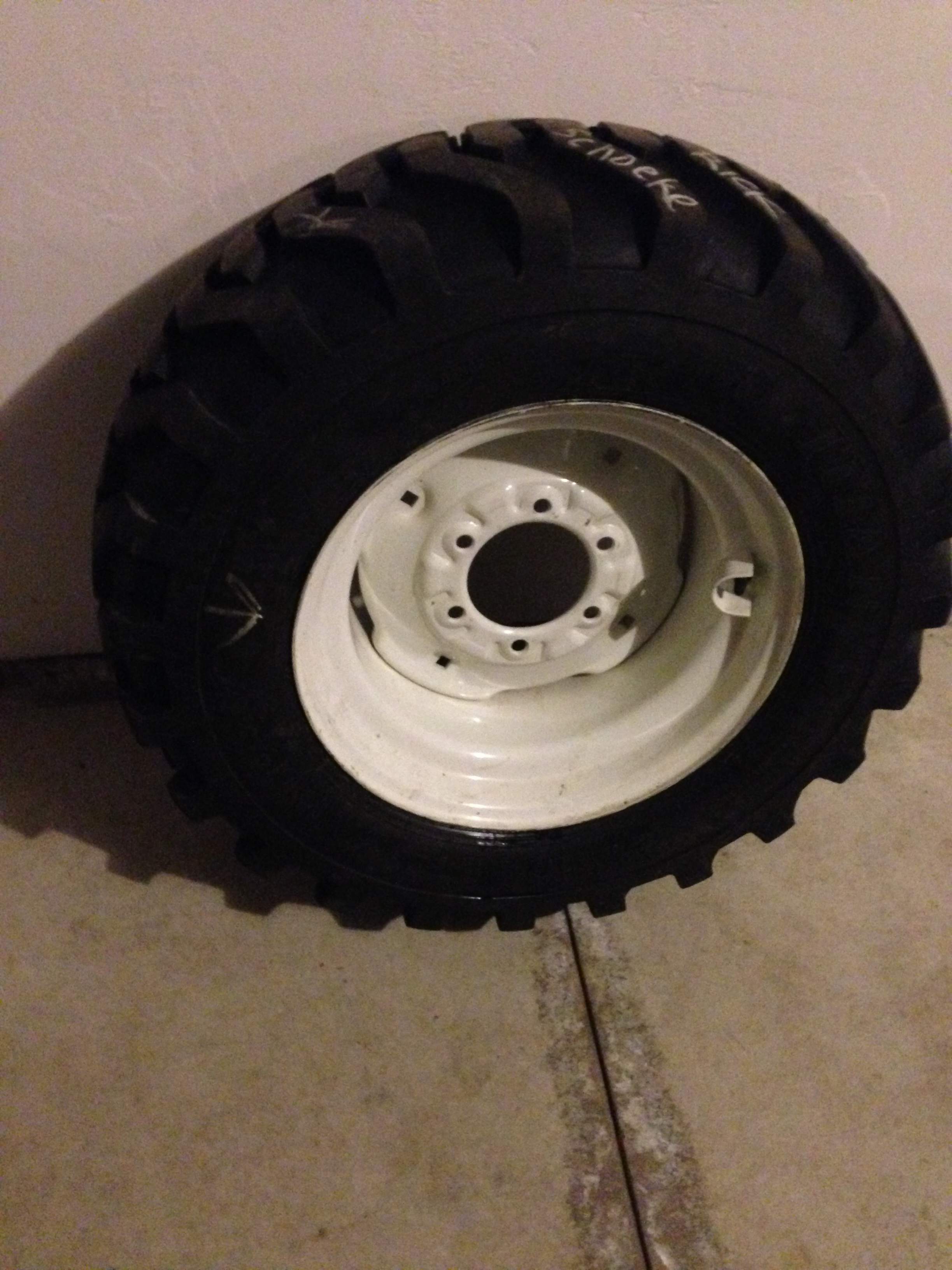

Dont look bad to me but id use a tube. you cant beat tubes in my opinion...there is alot of force sideways on these from wheels..but id first try to just mount it back up ..maybe some rim sealer.... nothing to loose.
   / Front tire slipped off rim #18
Unless you need the weight or are in an area prone to flats I think I wouldn't bother with adding foam. The two quick fixes would be a tube, as you suggested or bead sealer. Bead sealer is a black rubbery paste that gets applied to the rim. It's kind of like fix a flat / slime but will dry to a rubber like compound. This is the stuff I use, works well when I don't want to install a tube in things like car/ truck tires that have some corrosion around the bead or valve stem.
Bs-228 - BlackJack Tire Repair
#19
Pomp's Tire Service in Green Bay took care of repairing my tire. They identified a hole in the tread which they plugged and also installed a 10R/12R16.5 Tube ($20) to hopefully prevent further issues. The bead was not as bad as the first mechanic I had taken it to had indicated; they did apply bead sealer so the combination of tube and sealer should serve me well for hours on end. Thank you all for your comments, insight and options. Lesson learned. The next -15 degree day I may heed my wife's advice and stay inside stoking the fire waiting for the temps to rise a little bit before going out to play.
