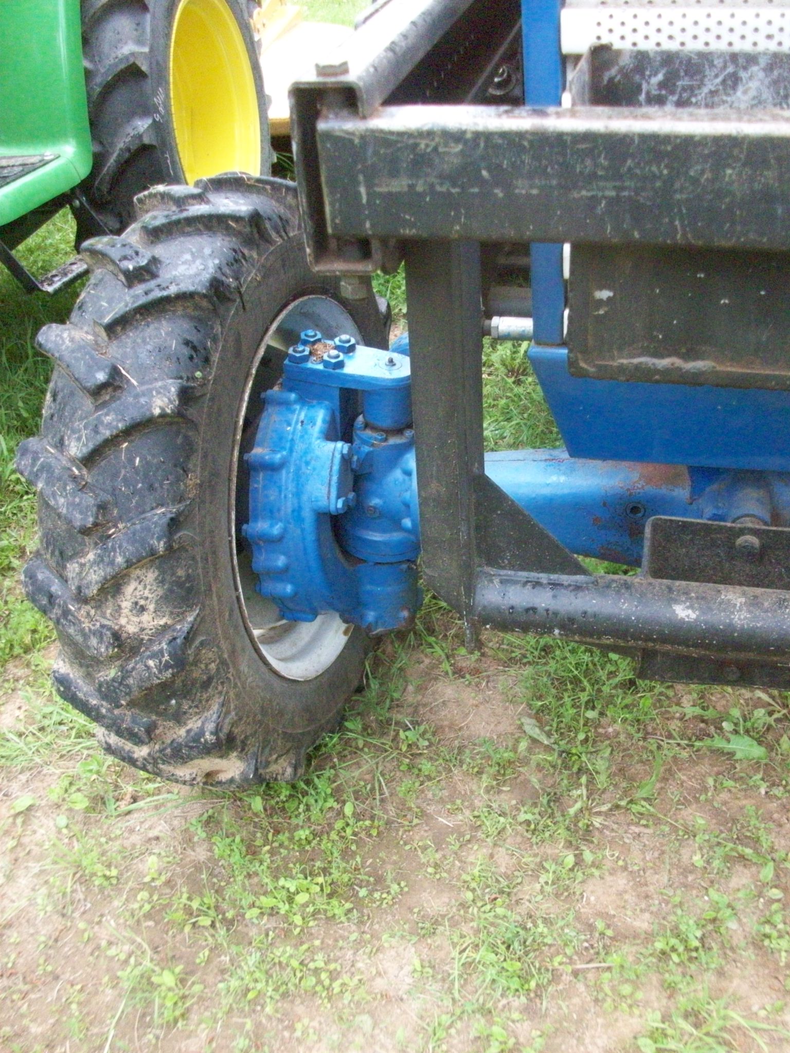

this is the outer housing for my 55 hp Rhino it may be "chinese" but they built this axle strong- outer drive housing is mounted in double shear, (Something Kubota and others do on some models but usually not their smallest CUT's) outer wheel bearing O.D. is almost 4 inches in diameter, the outer drive stub axle is retained by a large nut not just a circlip , ring gear must be about 13 inches since the wheel is a 20"
One of the few reasons I finally sold my 2 wheel drive Ford 3000. The front axle was just not up to lots of FEL work front bearings or axle strength. Ford addressed the front axle weakness with their industrial models and also made the oil sump pan out of cast iron to make it even stronger to support the front axle cradle.The 4X models like the 3930 and like Ford models use a design like the JD pictured above very strong and long lived.
The front axles on these new CUT's is a good thing to look at closely if the plan is lots of loader work.
i wouldn't want one that does not have double shear mounted outer hubs.
Placing all of the load on just 1 pivot turning surface is just not as good of design -jmo and the size of the front differential 3rd member/ pumpkin is also a bit of a worry from looking at some of these new 30-55 horse tractors.
I see most where there isn't even an increase in the diameter where the ring pinion set. Sure seems like back in the 1970-2010's MFWD tractors the front ring and pinion still seemed to be good sized,
Those gears just can't be very big to fit in those housings...
