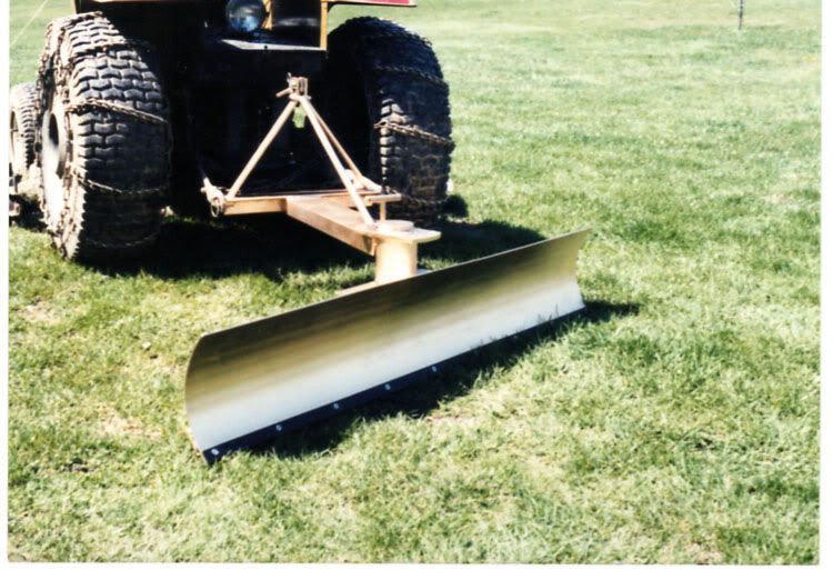

I started this loader design a few years back. I checked for a price to purchase one and was not having much luck or the cost was way to high. I started checking on plans that were offered on the web. I liked the P.F. Engineering site. Loader Plans, CAD Plans, Build a Loader, Front End Loader I'm a tool designer by trade and desided to design my own to better fit my tractor. I started by purchading some used cylinders from a junk yard. With the right length of cylinders in hand I started making drawings. I got lucky when I recieved some 4 x 4 x 1/4 and 3 x 3 x 3/16 tubing for FREE. I wanted my design to be practical and look good. I installed bronze bushings in the two moving joints, the uprights and the bottom of the tapered arms. I also have zerk fitting at these locations. I made my own hardeded pins by heat treating alloy steel to match the many lengths I needed. I wanted to have the bucket removalable mainly so I could fit my tractor in my small storage barn built years ago just for my tractor. With the bucket off it left a easy way to design other attachments, a brush hauller with grapple hooks and a pallet forks.
Here are some pictures of my back scraper I made in the early 80's. It will rotate 0,15 & 30 degrees both forward and backward and still cover the area of the tires.

Bunch of guys have done this to their cub cadets. They have an up grade front axle plan, with 1" shafts just for this application. Google search cub cadet, I can't remember the site just now. Ran across it 5 years ago. I agree about going up a size, or even two for the front tires. You may even consider going to 8.5x16 tires, 4 ply. That's a lot of weight now up front, and then there is the load of material. Going to have to have "armstrong" steering for that build. It looks great, and thought through well. :) Excellent craftsmanship;)
