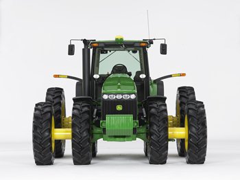

This thread started by Blake13 was a quest to get better flotation using wider front tires if I understand correctly. I see dual front tires used extensively on farm tractors for better floatation and traction with FWA and 4WD. Some even use wide spacers between the front duals pair to fit row crop spacings. I'm wondering if anyone has tried using front duals on the compact tractors for the same reasons.
I understand that "the tractor isn't designed for front duals" and that "it would put too much load on the FWA" but I'm sure those same factors apply in some cases to the ag tractors as well. That doesn't keep people from doing it and probably tends to cause the manufacturers to take these things into account in designing FWA but doesn't necessarily mean that the manufacturer would warrant using front duals.
It would seem of value to keep the dual pair close together as possible to reduce axle overhang and turning stress. Just wondering if anyone has seen front duals on a compact tractor.
