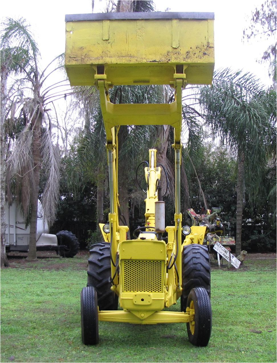

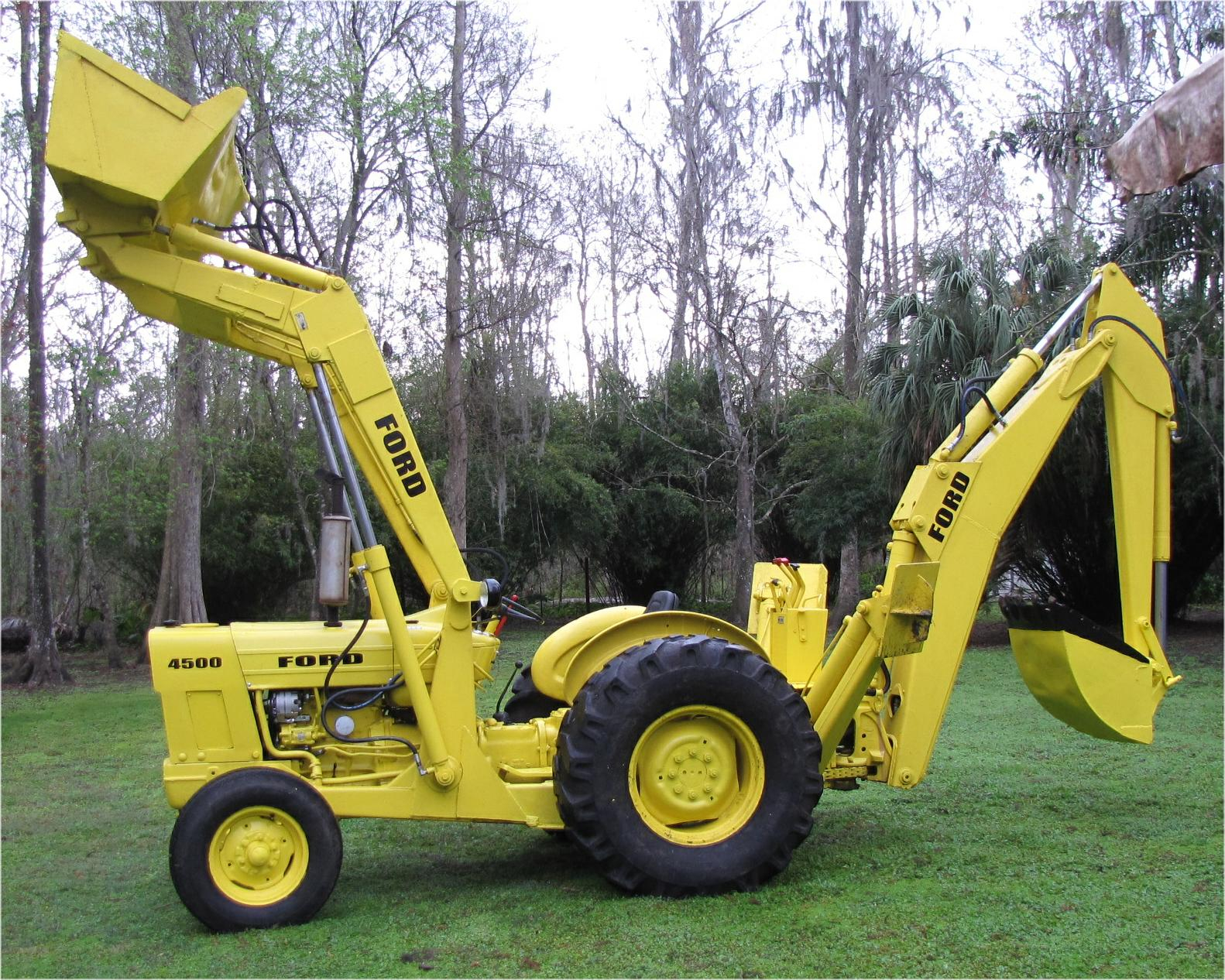

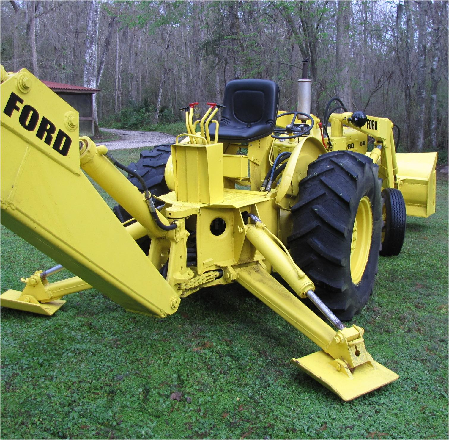

Nice looking tractor btw. Side and front views would be nice!
That was the right part number. Got the seal changed. No need in disconnecting the steering. This one only has one arm on the steering box. There was plenty of give to move the motor far enough to get to the seal. About 8-10" It would probably go more then a foot if need be with the steering connected. Heres a couple more pics.
