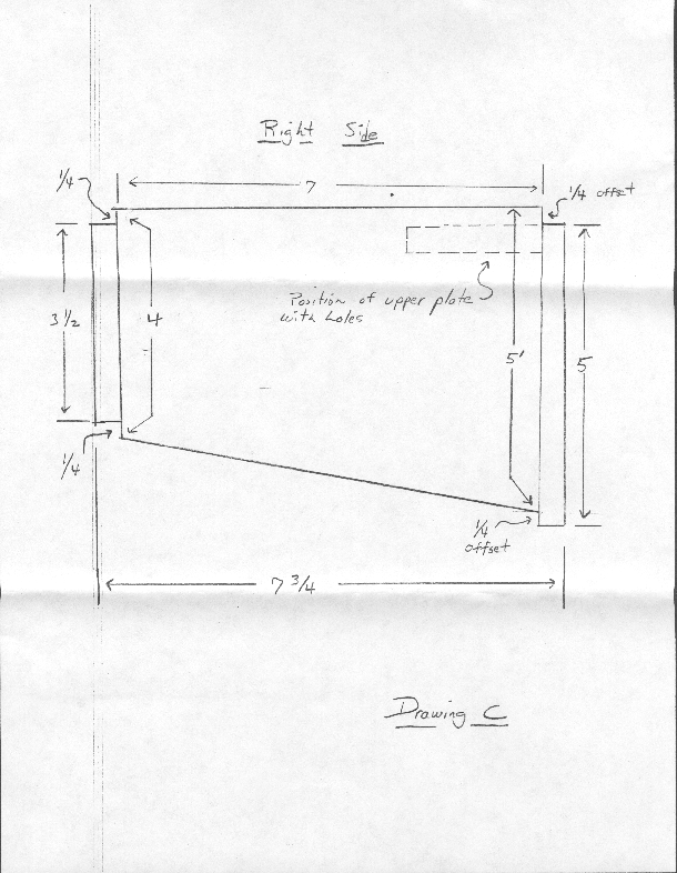

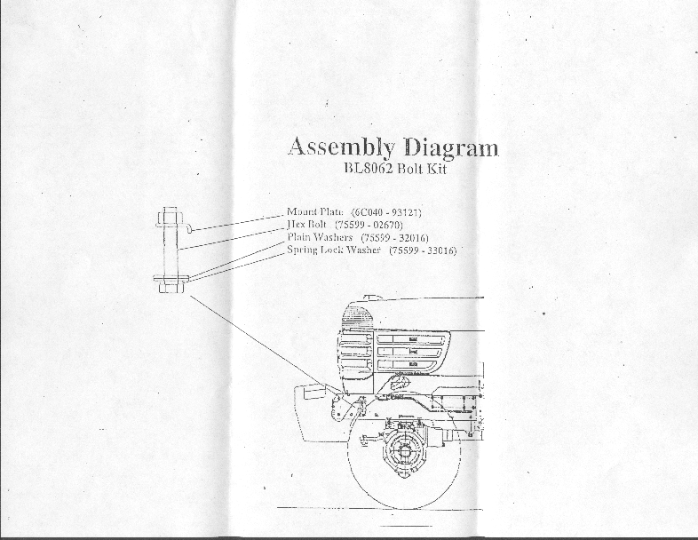

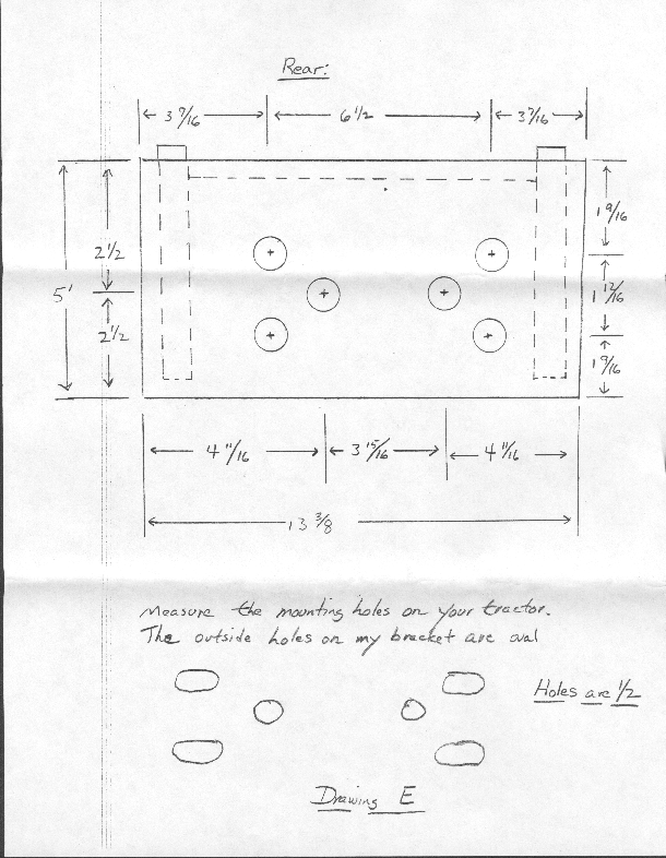

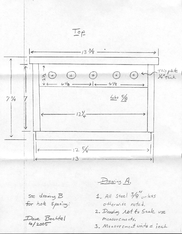

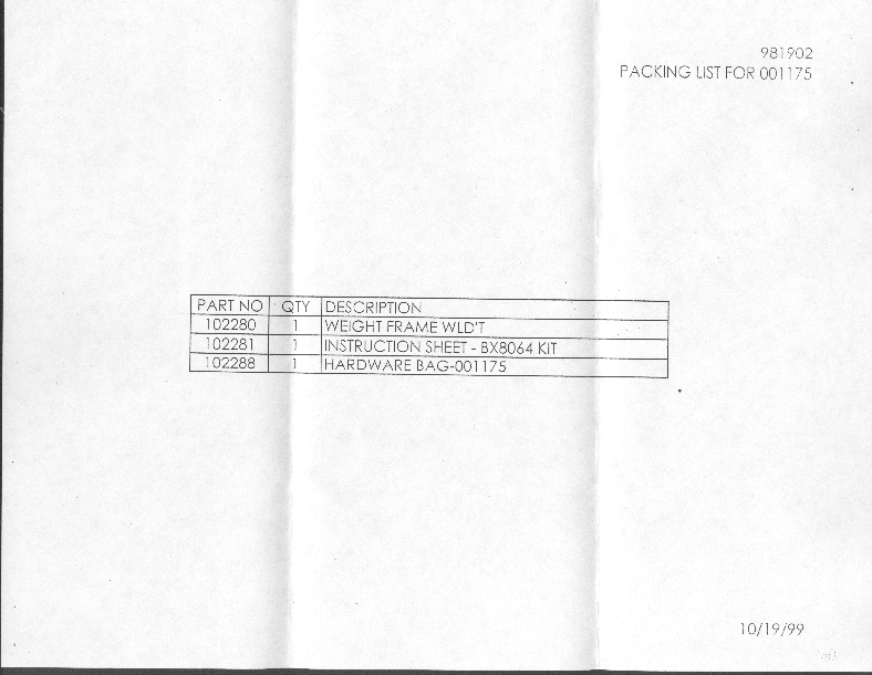

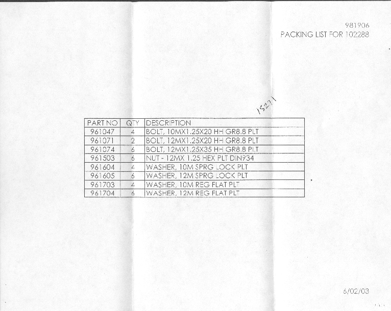

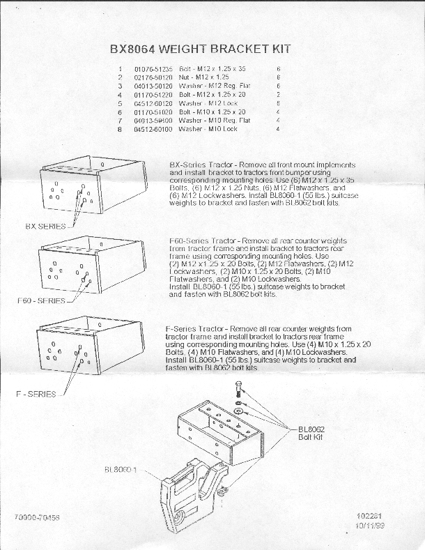

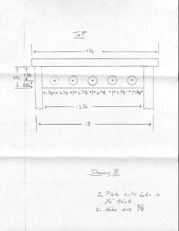

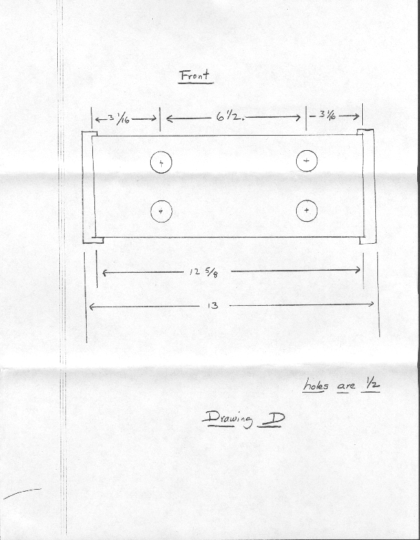

here is a series of pics from RiverV:
   / front weight bracket
#12
thanks for the pictures im sure i can make it im going to go draw it now
