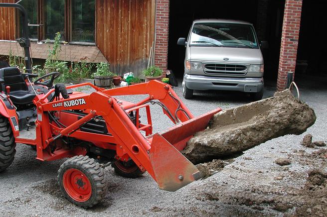

I've attached a photo I took the day before yesterday...amazed me the the b2910 did not flich picking up that concrete out of a pile of fill I had dumped in my driveway.
Loaded rear tires and a box blade on the back for ballast, by the way.
edit: I guess there are still some problems here as the attachment did not work, but it did yesterday [that thread was lost apparently...] I'll try to post that photo later...

Looks like things are back to normal now...
Here is a second try at that photo...

hey henro, why did not that chunk of concrete fall off the loader? enough of it sticking out.site can't be completly back to normal yet as u show as veteran with 14 post's' also nothing in your profile.

That piece of concrete was wider in the bucket than out at the end...it was pretty much balanced and it was BIG. I took it real slow and got it to where I wanted to drop it...it could have fallen out at any moment probably. The teeth of the toothbar made all the difference...
