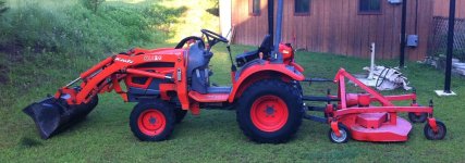

Ok, so I am no longer lurking, cause I think I broke my tractor yesterday. I have a CK20 HST that I bought a little over a year ago (used). Oh picture is below for those of you who like them.
So I was using my middle buster on a friends pasture yesterday when I heard a pop then my traction when to almost nothing. Figured it was the FWD, but had to finish what I was working on. Tinkered with it this morning and after taking the bend out to the control bar, I still do not have FWD, when I push on the lever it does not lock into a position at the bottom, it does at the top just fine. Tried the lever with the bar disconnected and same thing, no lock when moving the lever into FWD position.
So suggestions as to what I broke.
