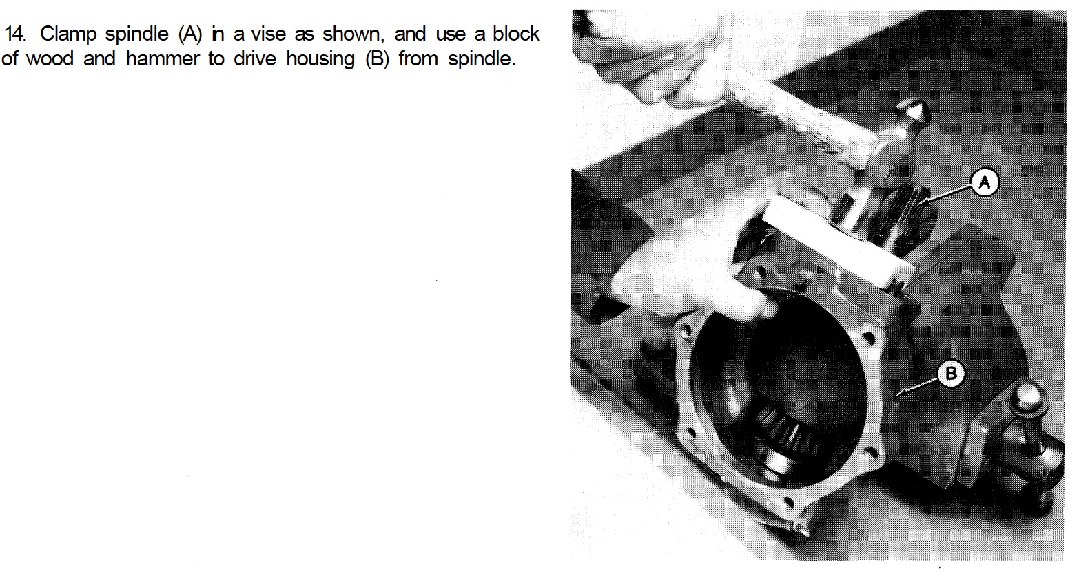

I was able to drop the housing on both sides and bring them inside to replace the seals the morning. Ran into my first gotcha, removing the spindle from the housing. Tech manual instructions below. Been mucking with it for over an hour and it's just no budging. Any advice? This is a stupid way to have to take this dang spindle out and I am worried about screwing up the drive gear (although it should be catching on the housing without screwing up a spline).
   / Front Wheel Drive on JD650 #14
My YM186D has that same axle,but haven't worked on it yet. Is the gear holding it?or the inner bearing race #19 ?? If the inner race is stuck,it looks like it will come out if you remove the upper snap ring,and you can remove it later. Is the bearing bad? If it aint broke,don't fix it.

#15
