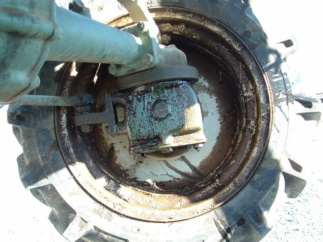

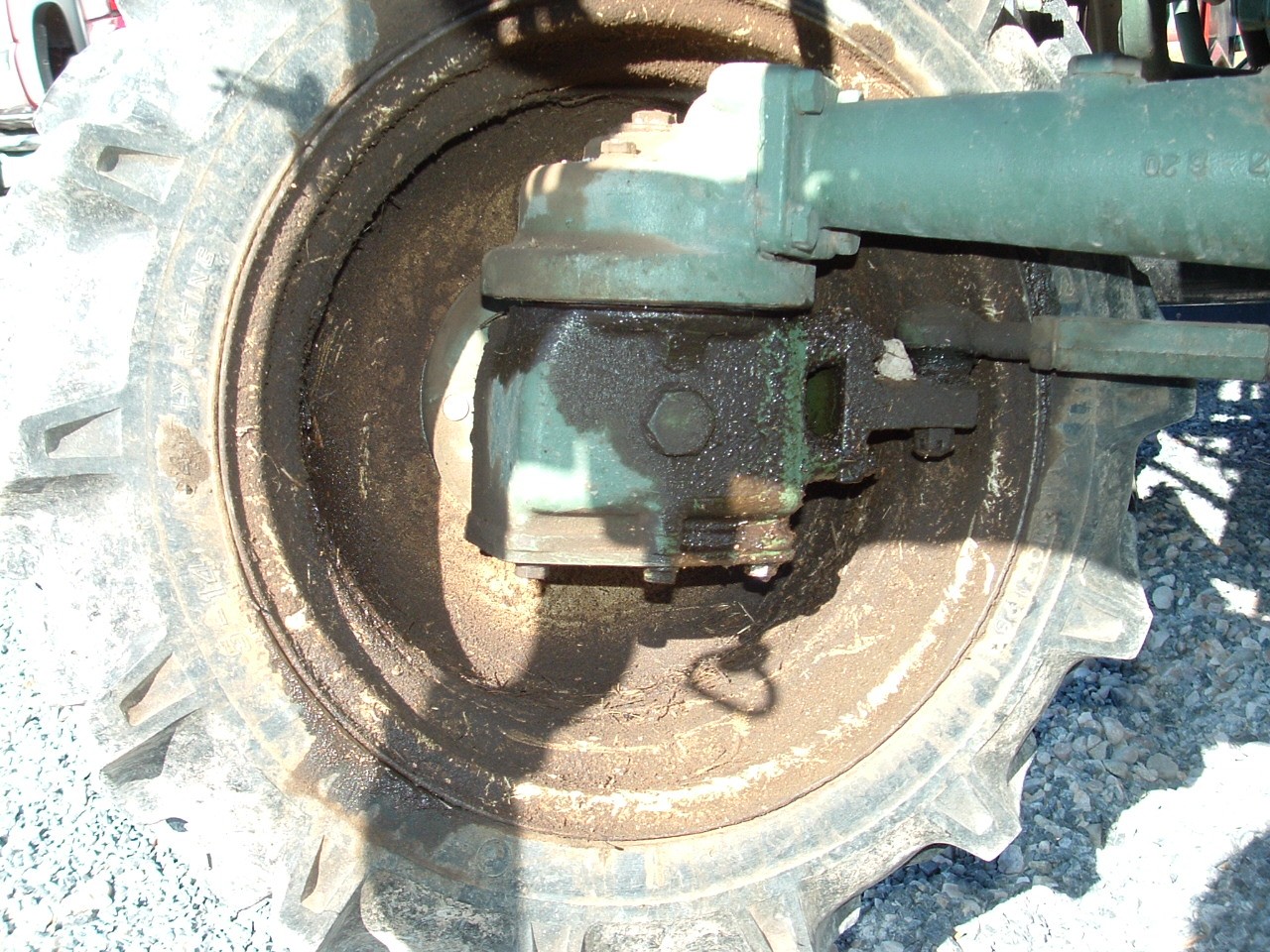

Getting ready to finally tackle the repair on Wednesday. I thought I'd post before and after pics.....
/ Front wheel seals #13
Mace,
Good Luck, you can do it. You might consider plenty of "during" photos too. They can come in handy during re-assembly.
Bruce
/ Front wheel seals #14
I would highly recommend you only repair one side at a time. You can then dissassemble the second side if you start questioning which way something goes back together. None of these parts are Yanmar specific. A good bearing store will be able to order them. You just need to take a good sample in for them to measure.
/ Front wheel seals
#15
I completed both sides. It was a lot easier than I expected. I was a little supprised on the one side when I drove out the bolt tightening the pitman arm to the top of the hub and the whole hub dropped. Luckily no fingers or toes were in the way.
Have to run the tractor a while to see if it will leak or not......
