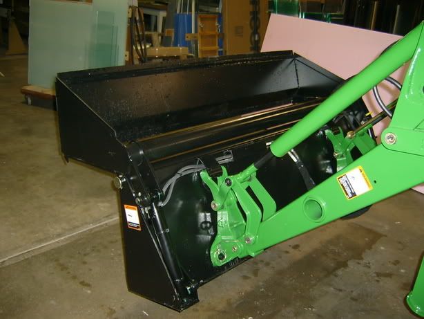

Here are some pics of the Fronteer 4n1's weak points as I see it. With a little time and welding they could be fixed.
Below pic:
Where the two lines run into the top of the bucket is a potential problem. Anything coming over the top of the bucket may snap off one or both of these fittings. Fix: Box in these fittings with a metal guard.
topbuckethoserouteweakpoint.jpg - Image - Photobucket - Video and Image Hosting
Below pic: Potential for damage on these exposed lines. Fix: Hmmmmm, not sure on this one. Have not thought about it much. Maybe someone here will come up with something that would help???
Below pic: This bottom piece is way too thin. Has the potential to wear quickly and or getting bent real easy. Fix: Weld additional steel on bottom to stenghten.
bottomcornerweakpoint.jpg - Image - Photobucket - Video and Image Hosting
There are also other parts that need "beefed up" with additional steel,but I'm not going to get into that now.
Sincerely, Dirt

I have previously expressed my feelings about the 4n1 buckets from my personal use also. I must say that Dirt's pix actually show hose routing that is less good than the 72" 4n1 I had on my 4520. This makes me wonder if they upgraded some aspects at the expense of others. I do not know what the consensus here might be but if I were planning to get a 4n1 I really would strongly look at the WR Long one as well. It is a much beefier and heavy duty bucket. It probably weighes 50-100# more than the JD bucket for equivalent size but it is really tough. It also has all the necessary plates for reinforcement welded on already. Dirt, I am sure, has seen a couple of the same weak spots I saw on the JD bucket, I left mine but I can see where one might wish to weld on some reinforcement plating.

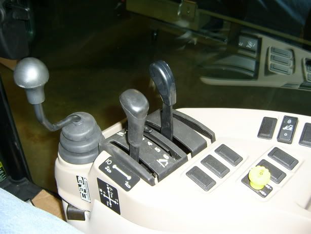

Here is the pic of my tractor....I have to use the middle lever to open/close the bucket....once you get use to it, it isn't that bad....but I would love to have the option right on the loader stick....
I have the 'older' JD 4 in 1...it is black:
I must admit, I love mine.....I don't do a lot of heavy lifting, just general purpose with is, and it has been great (especially when picking up brush piles and the like)!

Thanks for the pictures. Is that a WR Long bucket? They definitely have a solenoid operated switch and a replacement (screw on) handle for the bucket function. Having just spent about 5 hrs blowing snow this weekend, the cab tractor sure beats the open station 1070 it replaced-hands down.
