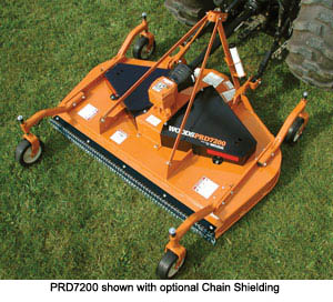

The Frontier mowers are made by both Woods and BEFCO. Both are great mowers.
If it's a Woods, the gearbox will have "WOODS" cast into it. Also, the front to side will be rounded (see the attached picture PRD7200). If it's a BEFCO, the front to side will be squared off.
I've owned both BEFCO and Woods...but my Woods is sold by Frontier and is, quite likely, the same mower you're looking at.
My mower was used (very lightly, from the condition) and the price was $1500. In my opinion, well worth the price.
That doesn't mean you can't negotiate with the seller though.
As far as the "stabilizer bars"...do you mean anti-sway links (reduce side to side sway)? If so, yes, you really do want them. Your profile doesn't list a tractor...it lists a skidsteer and a lawn tractor or Zero Turn mower. What kind of tractor do you have?
BTW, it's a good possibility that Frontier mower you're looking at is set up for a quick hitch....mine was.

As noted, the Frontier is probably a Woods unit. New, the prd7200 sells for $2000, so your dealer is in the ballpark. I have the PRD8400. Great unit. Definitely need the sway links. Good luck. Let us know what you buy.
