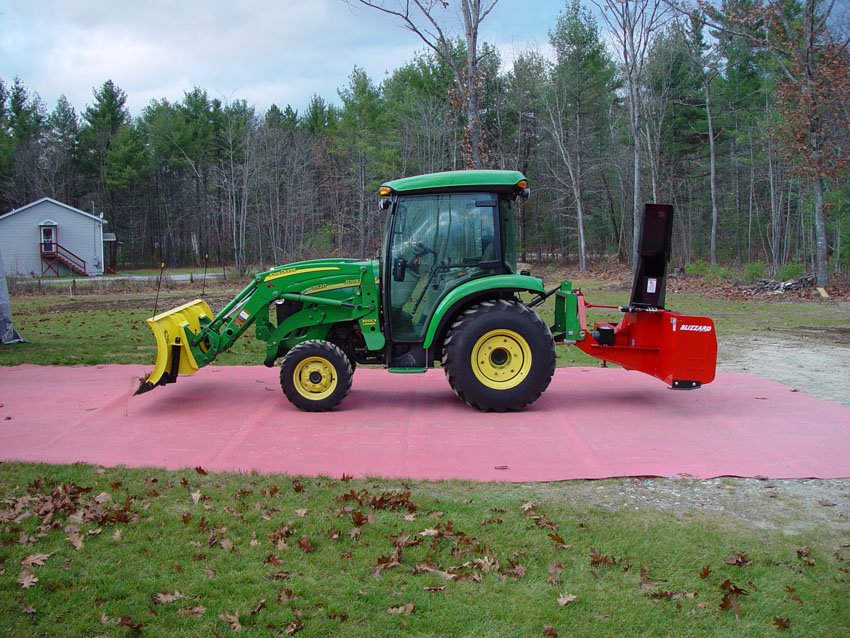

Hello again fellow tractor lovers. Well I decided to go with a rear PTO driven snow blower. Only this one faces forward so you dont have to back up to blow snow. Its 75" wide and works like a charm. Throws the snow 30 feet away! And you don't have to bother with a hydraulic pump or loosing your loader. Its made by M K Martin Enterprise. Priced in the $3,000 range. Here is the link....
Pull type snowblowers for light duty
/ Frontier Front Blower #33
Does it have specs for depth of snow it can handle? Seems that it could get you stuck in deep snow? but I dunno?
