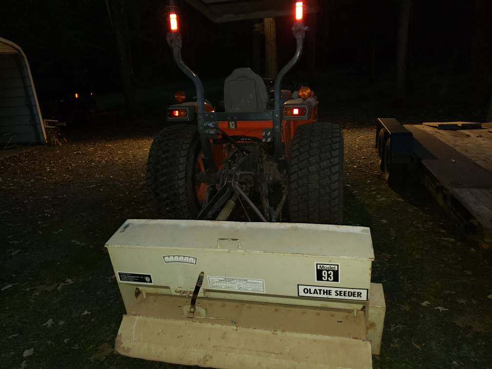

I run a 4ft slit seeder, no roller, germination rate is excellent. It's relatively unintrusive to existing turf and de-thatches at the same time.
Mine is an Olathe (now sold under the toro brand), I'm not sure how well the nonpowered type do, especially for overseeding without tearing up existing turf.
I imagine a clutipacker attached to the rear might help, maybe one day I'll try adding a cultipacker to it, or just roll afterwards.
