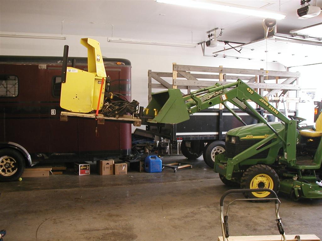

Attached is a photo of a set of Paynes medium duty forks being used to move my snowblower using a JD4310. In this case I did not have the ballast box mounted and I do not have filled tires. I wanted to test the balance of the load so I was very careful. It was very comfortable on the hard, level floor although I would never take it out of the garage wihtout ballast.
