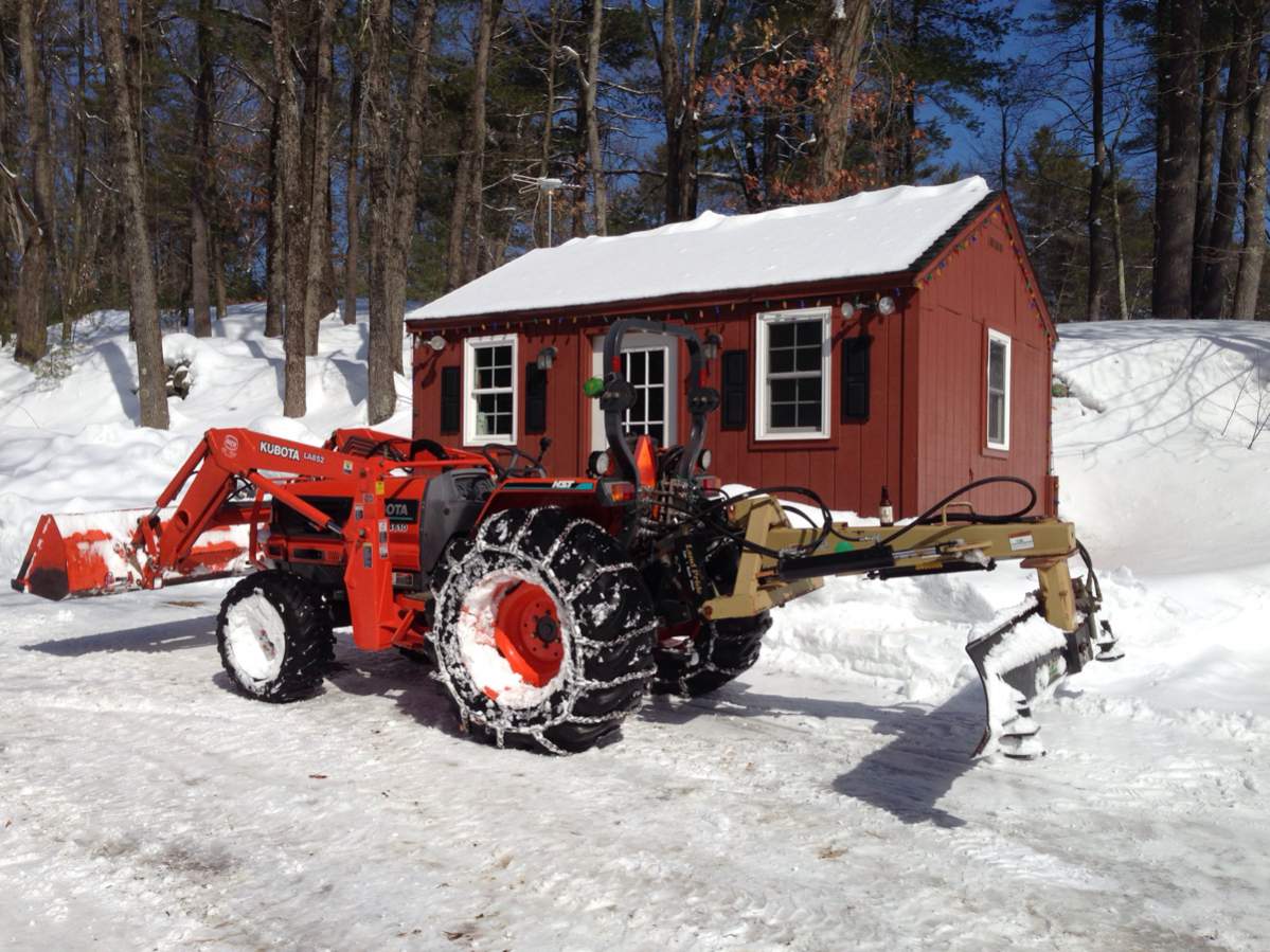

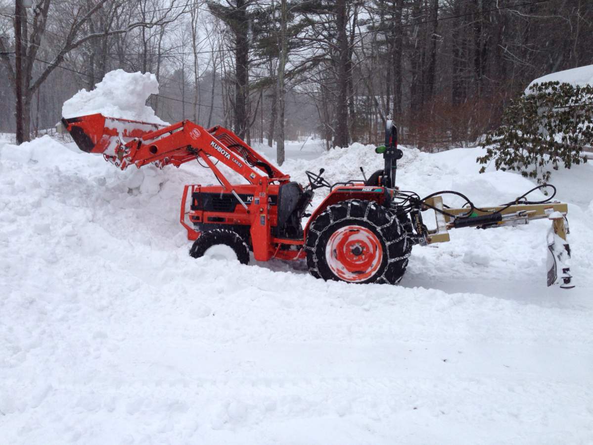

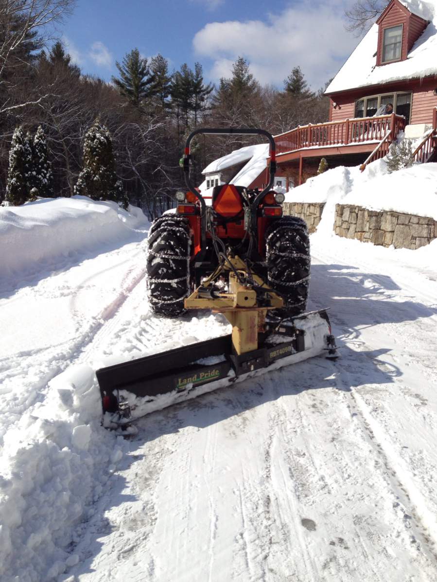

I'm not sure exactly how my rear blade compares to the 2308, but I have an 8' landpride rbt4096 with the 3 way hydraulics, it weighs between 1,000-1,0lbs with the hydraulics included and I'm pulling it with a Kubota L series tractor and filled rear tires. My tractor ballasted with the FEL on weighs right about 6k lbs.
I absolutely love the blade for snow removal and my little tractor handles it admiraly. When using it in dirt I can't take too big of a bite but I mostly only use it for more finish work than anything. For rough work I use the box blade.
I prefer the rear blade to the front blade for snow removal because I use my bucket a lot for moving snow as well (some of the few times I don't have the grapple on).
Having the blade angled cuts down on the width quite a bit and still covers my tracks. With the RX6010 I think your tractor would handle a similar size blade even better. I also use chains.
   / Frontier RB2308 8' full hydraulic blade on a NX6010 #6
Here are a couple pics of my setup I explained in my previous post.
Also, I leave my tilt cylinder on the blade in float all the time, this allows the blade to tilt with the terrain and stops it from digging in one corner when I'm transitioning from anything not perfectly flat. It keeps the blade in contact with the ground all the time.
I also set my skid shoes so my blade is about a half inch or so off the ground when my 3 point hitch is down, and my top link cylinder is mid stroke. Then, I put my top link in float as well and this allows me to change the cutting angle (which also brings the blade lower or higher) as I adjust my 3 point hitch.
I think having these abilities is the reason I really like the rear blade for snow removal. Without the ability to float the tilt cylinder It wouldn't be nearly as effective for my situation.
Oh Ya, a top link cylinder is pretty much a necessity for me, you'll certainly want that 3rd (and fourth if you get a hydraulic blade) remote.

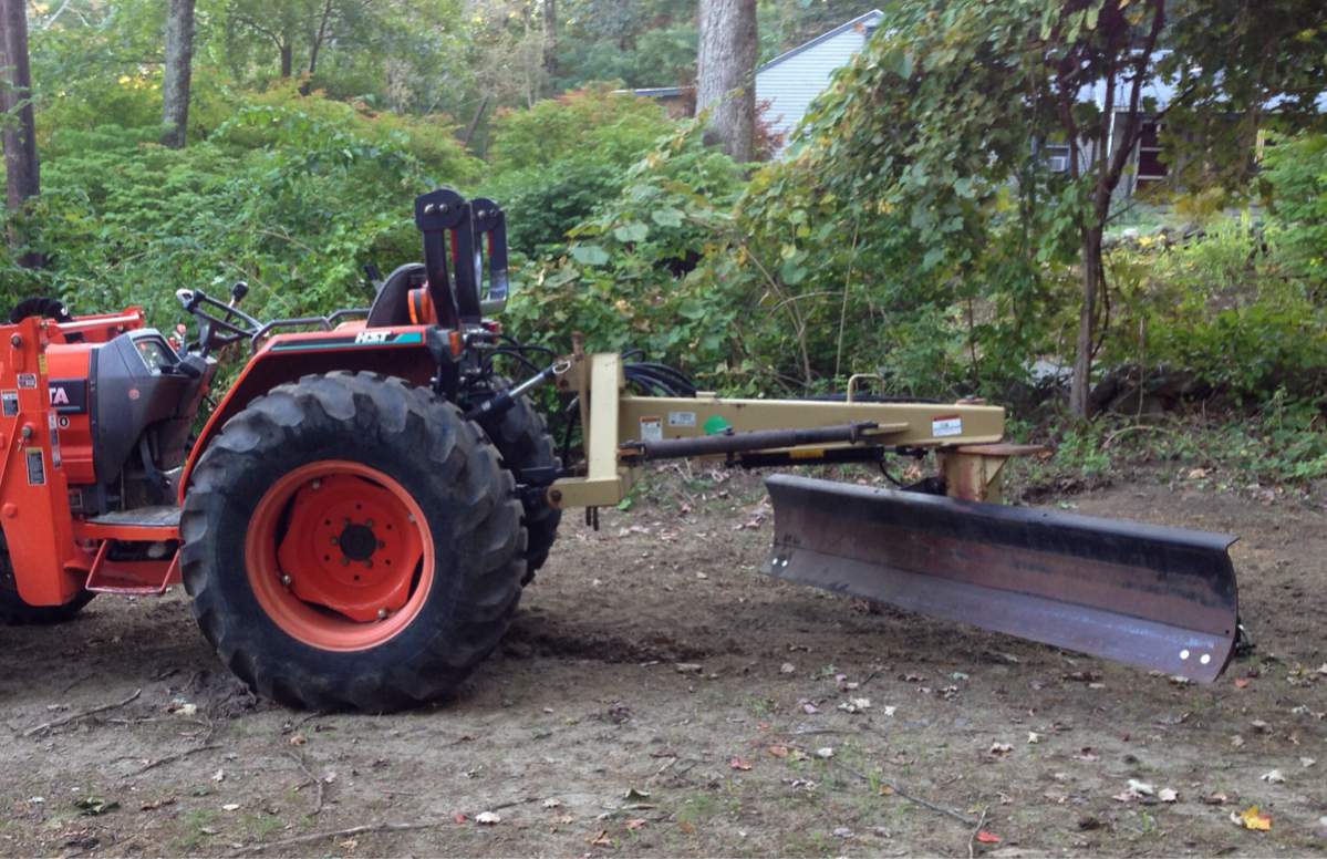

Once you use that 1100lb blade, you'll understand. When you guys say bite, just how much are you thinking? I'm cutting 1" in the picture. Not sure what you think a good bite is? :confused3:

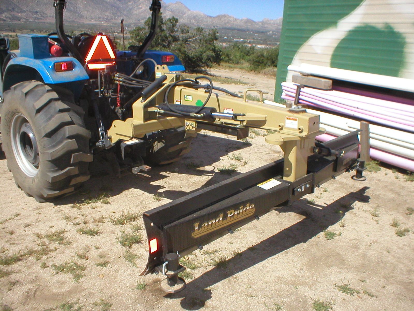

No, actually a 9' blade, and yes a 12,000lb tractor. But I am hoping to get in the not to far future a 900lb 7' blade for my 5000lb 32hp tractor. I know that I had a 680lb 8' blade for my big tractor for a couple of years, and while it worked ok, nothing like this Land Pride RBT45108 does.
Why would you be stuck with it? :confused: I would think that you could sell it and get that amount for it easily, that is a good price for that blade with all 3 hydraulic adjustments.
There have been a couple of TBN members with your size or smaller tractors get 1000lb+ 8' rear blades and had VERY GOOD luck with them. I can't see why you would be any different. Grading becomes almost a joy when using 1000lb implements. :thumbsup:
