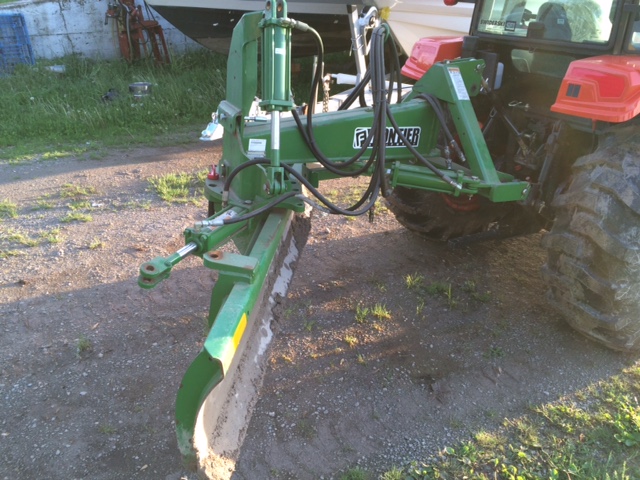

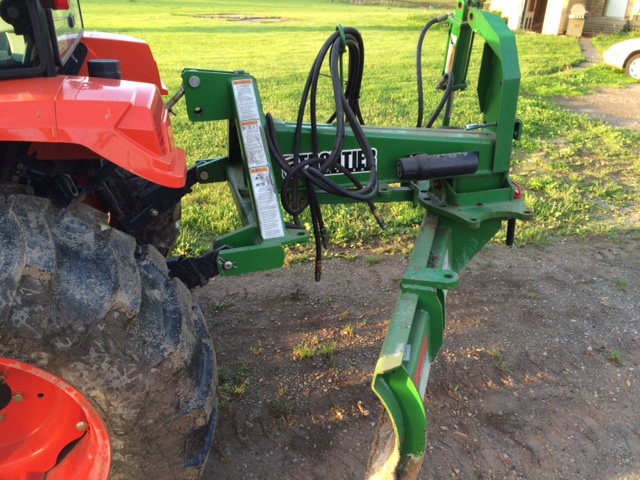

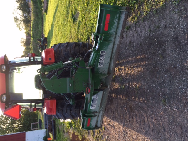

It's here. I disconnected the two cylinders until my third remote comes in (or, second second remote :)), when I will install all 3 remotes at once.
It looked positively HUGE when I first walked up to it. It still looks big on the tractor, but it's a lot less crazy looking than I thought. Can't wait to make some drainage ditches with it :)

Looks to be a good fit to me. :thumbsup: Action shots requested. :cool:

That looks great! I think you'll be really happy with it, and you'll find that it works a lot better with your tractor than you thought it would, that's what my experience was anyways. Sometimes I realize the tractor is a lot more "capable" than I realize. :D
I absolutely LOVE having the 3 way hydraulics on it.
I only have 4 rear remotes, but between top N tilt, and the 3 blade remotes, I really would need one more to be able to use all the functions. I tried leaving the blade tilt cylinder disconnected and using the side link to control my tilt, but I find that I like using the blade tilt cylinder a lot more than the side link. So, what I do, is disconnect my side link cylinder hoses, and leave it disconnected, then use the tilt on the blade.
I use the Top link cylinder all the time though.
