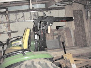

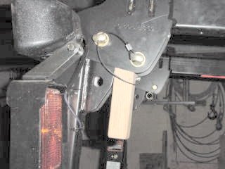

Attached is a picture of my solution for installing & removing the backhoe in my low ceiling garage. I made a block to hold the rops up at a 90 degree angle to the supports. the block is 1 3/8" thick, juct wide enough to fit inside the hinge & I ground a small indentation in it so the pin will hold the block in place.

A closeup picture.
