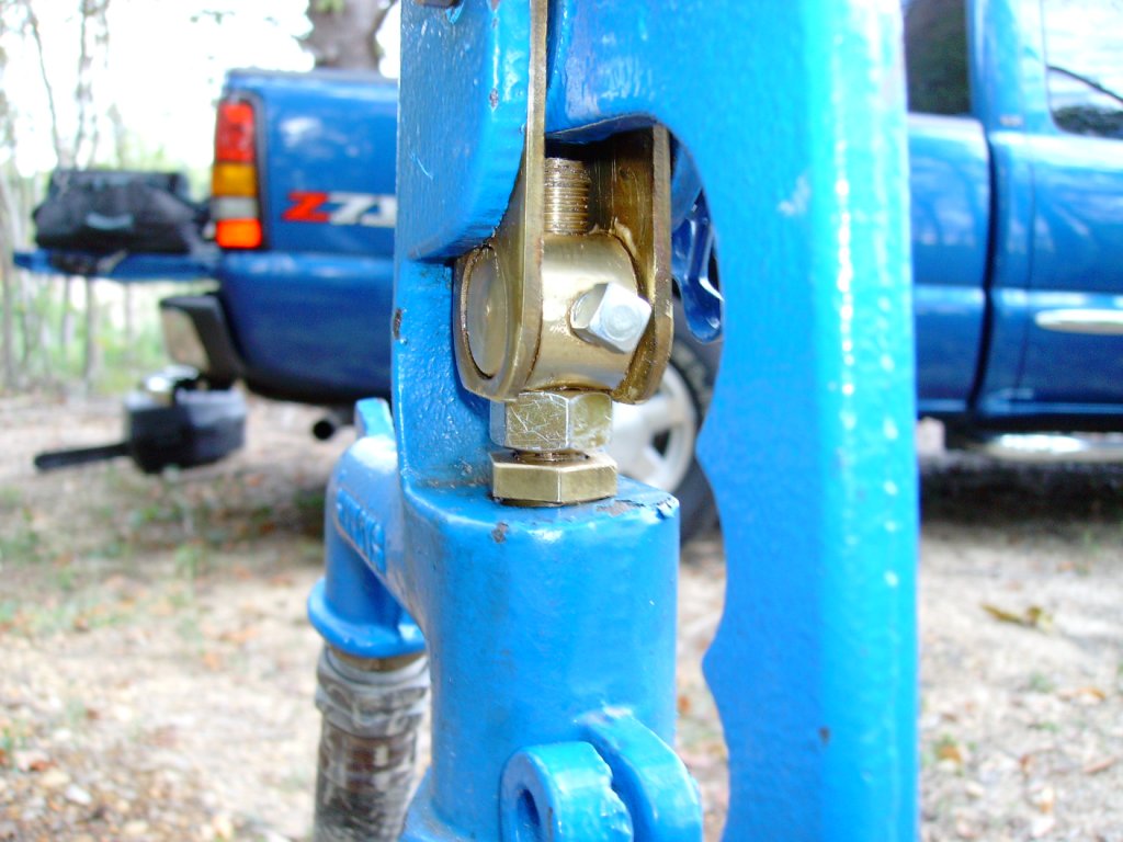

You'll probably find a valve similar to this one pictured if you dig down to it.
There are a few ways to test the drain ability of the weep hole without digging and that's what I'd check first. I don't especially like diggin. One way is to put some water in an attached hose, elevate the hose and it will empty if the drain is open. Another way is to attach a short hose and blow on it. If it's open you'll loose pressure between your little ole puffy cheeks.:D Tree roots are often problematic in the drain area. A brother of mine has to blow his out with an air hose every 3-4 years.
The instructions with the last rebuild kit I bought said to adjust the handle to 30 degrees after the plunger just touches the seat. I've found about 20 degrees works and isn't as likely to cut the neoprene as the one pictured from the factory. Lubricate the moving parts so you can get a better feel for what's right. You may find they sold you a lot more parts than you need. What a waste.

we purchased some heat tape the other day put it on , and covered it with some feed bags. It is working again but is dripping, which obviously caused the problem. Is there an adjustment or should we just order the "kit" for it ?
/ Frost Free Hydrant Failure #14
I think if it is leaking then you need a tighter adjustment on the handle to better seat the plunger or you need to replace the rubber plunger. You might have possibly damaged the plunger trying to free it after it froze.:mad: The plunger is the black thing in SandburRanch's 2nd photo. That one is damaged.

where exactly is the adjustment on the handle, i think there is one flat nut about 3/4" or so ? not out there at the moment.I did not try to free it after it froze.

Adjustment for the handle is the square head bolt that threads through the handle against the brass stem.
/ Frost Free Hydrant Failure #18
Not all designs have a nut for adjustment - I have a bunch of "Simmons" hydrants that just use a setscrew on the main shaft.
- Jay
/ Frost Free Hydrant Failure #19
After one of the setscrews stripped, I did a bit of re-engineering on one of mine and added a "regular" adjustment nut....

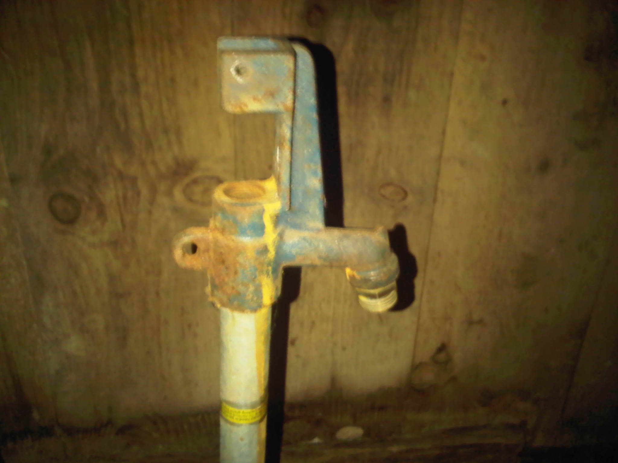

On a related front - can anyone tell me the manufacturer of this hydrant? I need to replace the plunger and all the replacements I have tried are too large? There is no manufacturer name on the hydrant itself.
