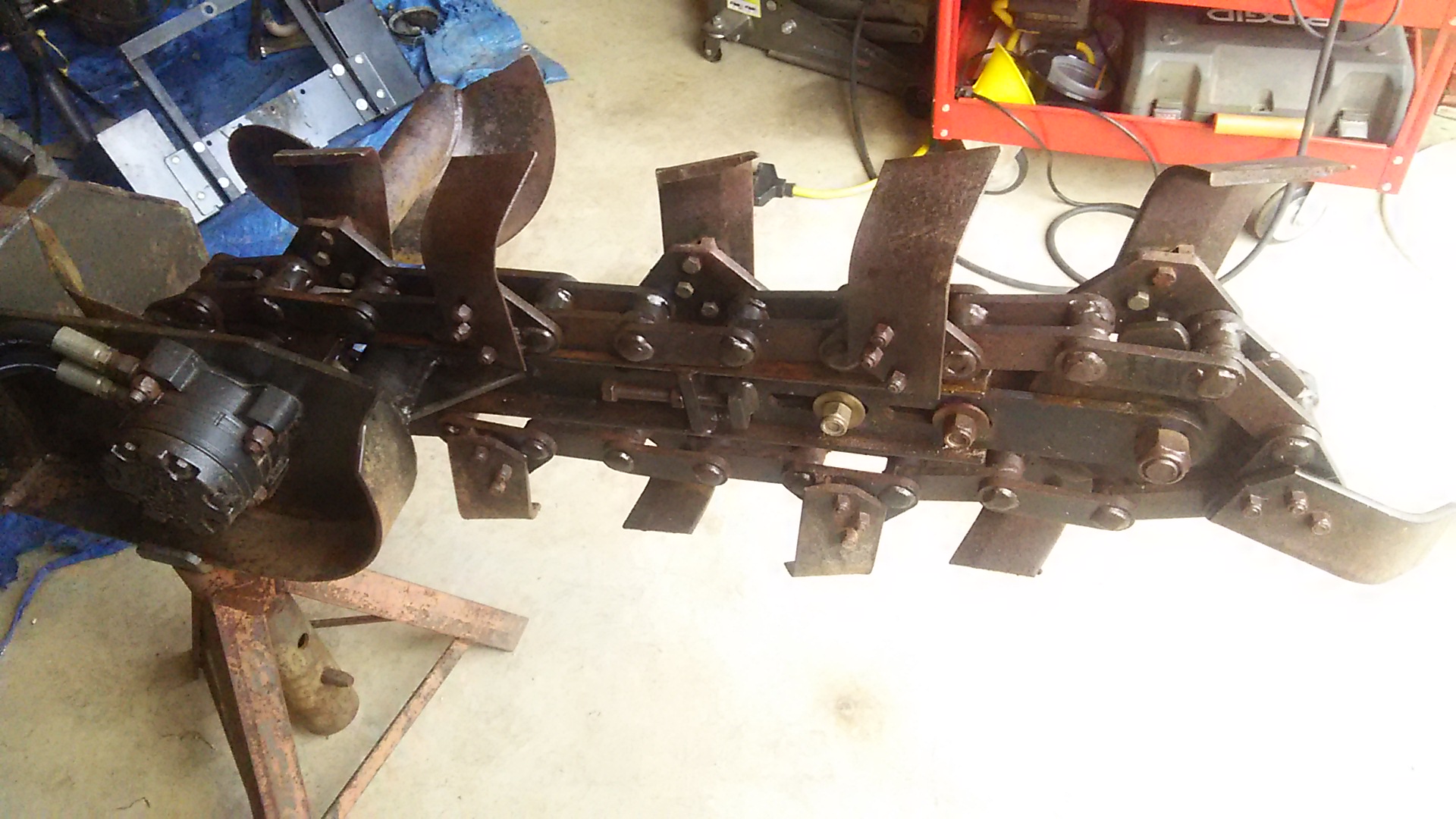

I bought my used PT-425 back in November along with a trencher. Clearly the trencher had been sitting outside for years unused, as it had a bit of rust on it. trencher didn't look heavily used before it was parked outside, as the teeth weren't beat up or bent.
This weekend I decided it was time to start on the thousands of feet of trench I have to dig for drainage. Hooked up the trencher, flipped the PTO switch and . . . nothing. Trencher is frozen.
I sprayed everything very liberally with spray lube and beat on the thing with a heavy plastic dead blow and tried again - just a slight jerk when I flip the PTO on, and nothing else.
Sprayed some more, waited 24 hours, loosened the tensioner up all the way. Still no spin of the trencher. Right now I have it sprayed in more lube. I'm thinking I might need to take the chain off of the trencher and beat every link with a hammer to work some movement and then reinstall.
Surely some of you have a trick I haven't tried yet. Any thoughts?

It sounds more Hydraulic. would be surprised if it is the chain (the forrce of the motor should break it free, I mean the thing is breaking up rocks and everything).
Does the engine bog down when you turn on the PTO? If it doesn then I would remove the chain to make sure the motor is turning. If it does not bog down then you got a bad motor that is bypassing or....

The engine bogs down when I turn on the PTO, and the chain bumps (like it's trying to move) a couple of millimeters or so, and freezes. Engine definitely changes it's tune when I put the PTO on - it doesn't die out or anything. I assumed the hydraulic motor on the trencher bypassed fluid if it was so rusted as to not be able to turn it. I guess I'll try to remove the chain and see if I have a spinning motor . . .

Sure you don't have a stone caught in the teeth somewhere you can't see? Every now and then I get one lodged in really good and everything stops until I break it up with a chisel.
   / Frozen Chain Trencher #6
Yeah, I was thinking maybe a rock is binding it somewhere.
As others have mentioned, look for obstructions.
IF no obvious obstructions, then try removing the motor (or chain) and seeing if the PT can spin the motor with no load.
IF motor doesn't spin, motor problem.
IF motor spins, chain or track or sprocket problem.
Start at the beginning and move along down the line until you find the issue.. ;)
I love IF, THEN troubleshooting. :laughing:

Thanks so much for the help and advice to everyone. I came home from work with just a little daylight left and set to work. I examined each link and tooth on the sprocket very closely for rocks and obstructions, and I loosened up the tensioner again. Then I cleared space in my garage so I can work late into night to take it apart piece by piece. Pulled her into the garage and started getting tools ready. Decided that I might as well try the PTO "one more time" before I started taking the motor off. I flipped the PTO switch, and lo and behold, after a slight pause, a mighty racket let forth and the trencher was spinning! I tightened up the tensioners and tried it again. It spun just fine and I soaked it in lube while it was running. I suppose patience is what I needed to let the lube set in - I never even got the chance to try melting candle wax into the links. Anybody know how to set the tension right on the chain? I am excited to dig trenches now, even though it's supposed to snow Sunday . . . DSC_0200.JPG

To set tension- put the chain horizontal and off the ground. Adjust the distance between the center of the lower chain and the bar above so it is the width of your fist. Got that from Terry many years ago.
