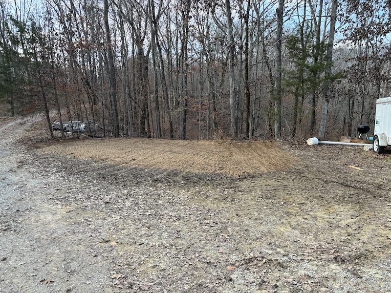

Help me think through this please. Don't deal with frozen ground a lot and haven't spread tons of gravel definitely not this large. I need to get gravel down on my mill site. If has been a little wet so I have been stalled out, now the ground is frozen pretty good and it probably won't thaw much for the next week. My goal is to get some 2-3" chunks of crushed concrete down, I plan on using geotextlie material under it entire area. It seems to me that this is a blessing. My main question is how will it act when it thaws? I won't be able to really pack it well and build my mill base on it until we get a good thaw in a week, which is a bummer. The dirt was moist but pretty hard when it started t freeze. Anything I should be aware of putting gravel over frozen ground.
Edited to add:
This is for my new sawmill site that will have a 6x6 pressere treated base. It is not going to be a house or shop of anything. But I obviously still want it pretty well packed.

No No nothing like that. It has about 18" of nice compacted fill at the back end. Pretty flat.

If it was already fairly hard to begin with you should be fine. Just spread as you would normally. If you intend to run a compactor over it, wait till it's thawed to do that.

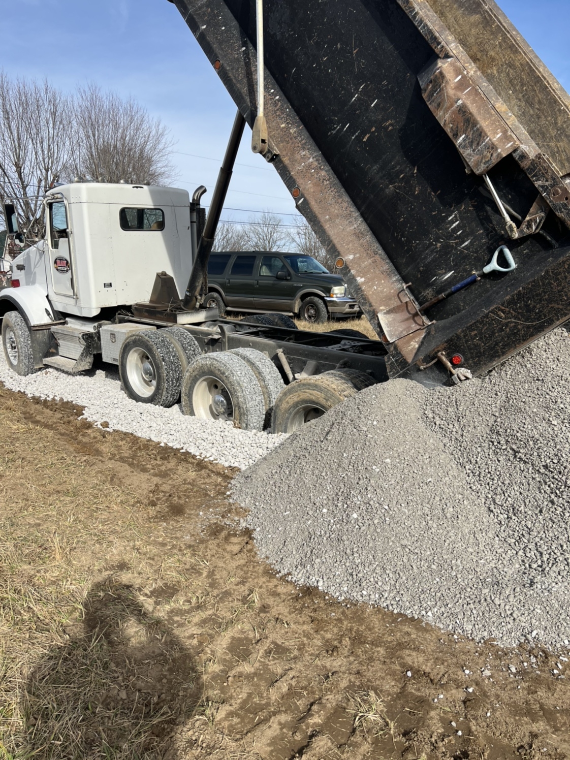

Well I already have a good layer of 3" crushed concrete down and I put geotextile fabric under it so hopefully that solves my mud issue. That is why I wanted to get it down while it was frozen. I am going to go over tomorrow to pack it down. I won't mind if it sinks down into the dirt a little bit, it will lock them into place.
