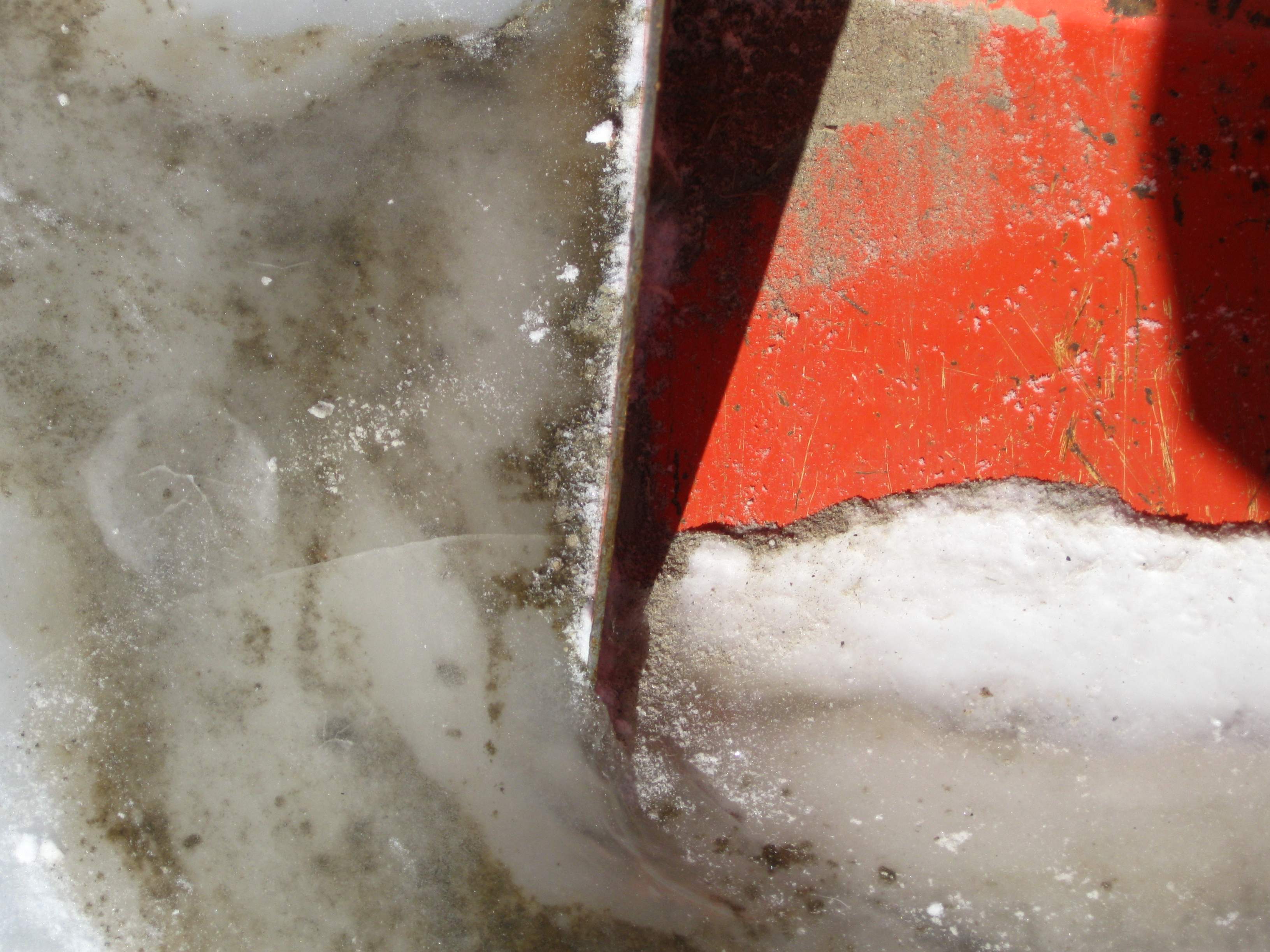

Hadn't though about pulling the pins and backing out, would work certainly- but I do most work with the bucket. Tried a little bit of the sledge, need to put down more sand on the ice first:eek:
The last of the ice around the tires (very little) melted yesterday...and the water flowed down to the bucket! As i start on this adventure today, i will have to chip away a channel for the water to flow through AWAY from the bucket.
Took some more pictures- swept away the snow and different angles, please enjoy a laugh, but don't spill your coffee on the computer!

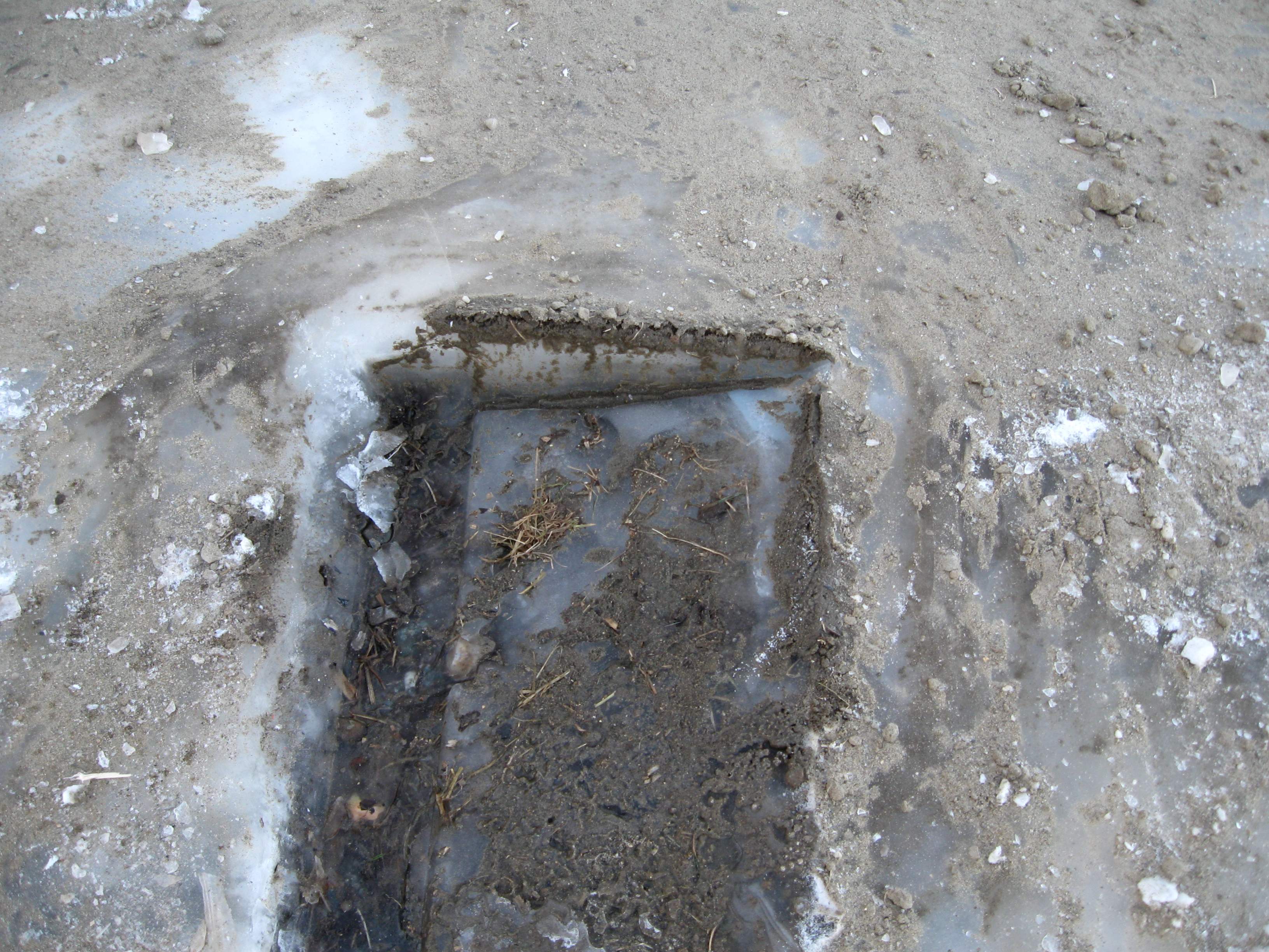

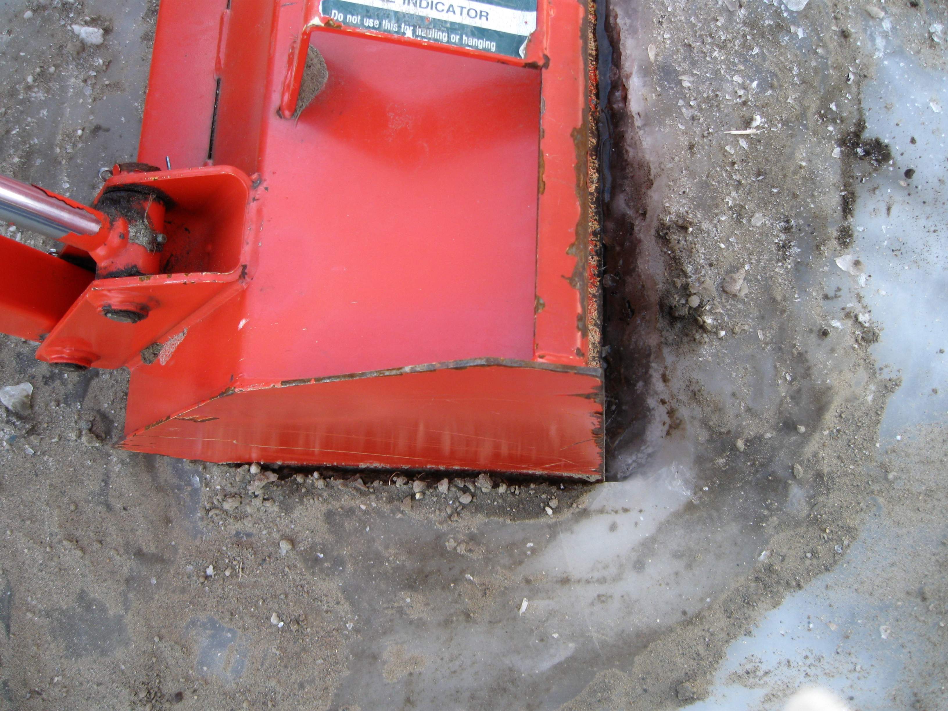

Well....the deed is done, with great results:D

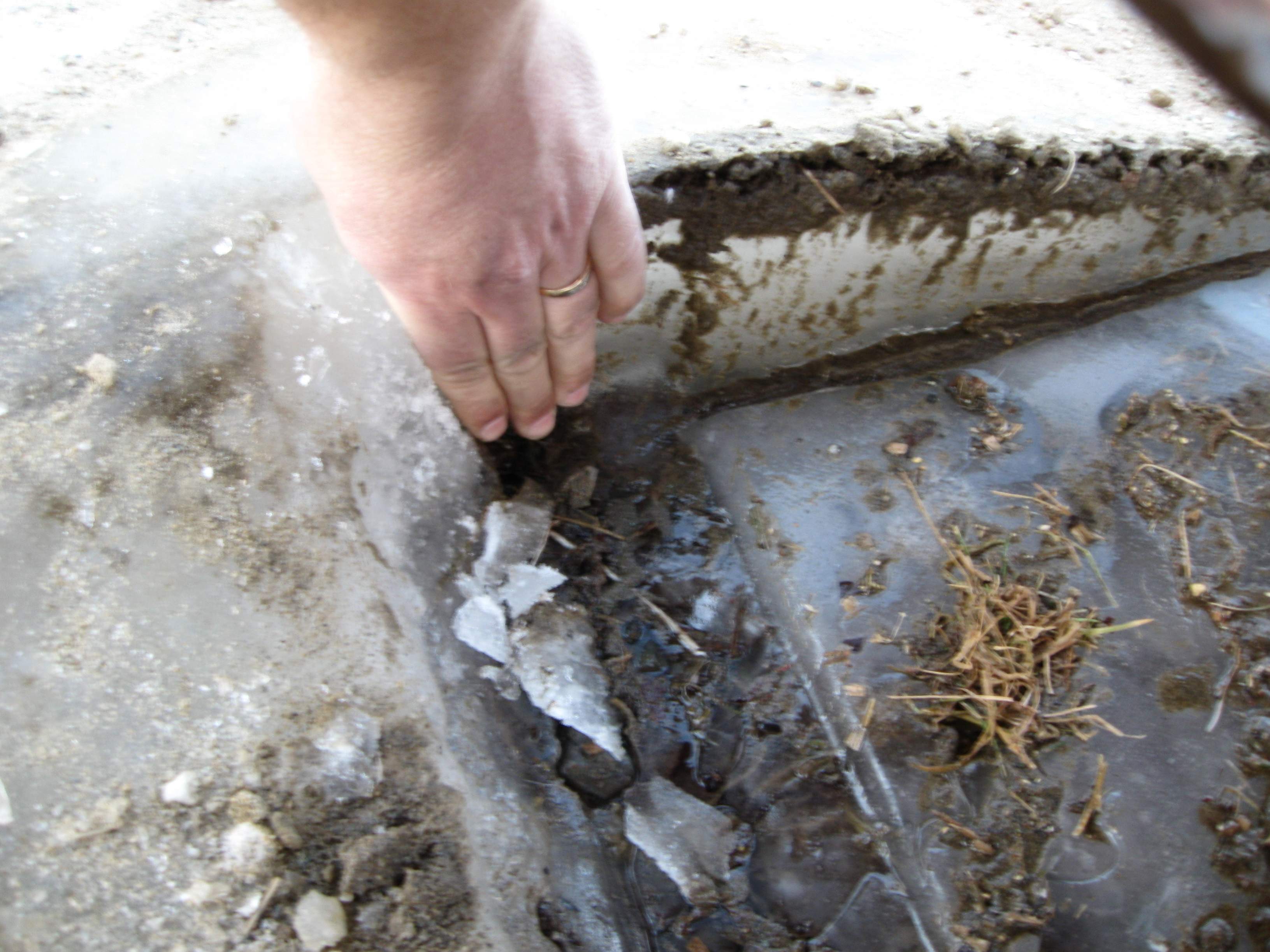

The biggest issue was the ice slab was huge and the bucket was frozen in at different depths side to side. The one side probably would have broken loose easy, but the other would not- i was afraid of serious twisting potential and that damage that may result.
I did use a round point shovel to loosen up the ice inside the bucket and to find the lower edge. That worked pretty well, but there was still allot of ice.

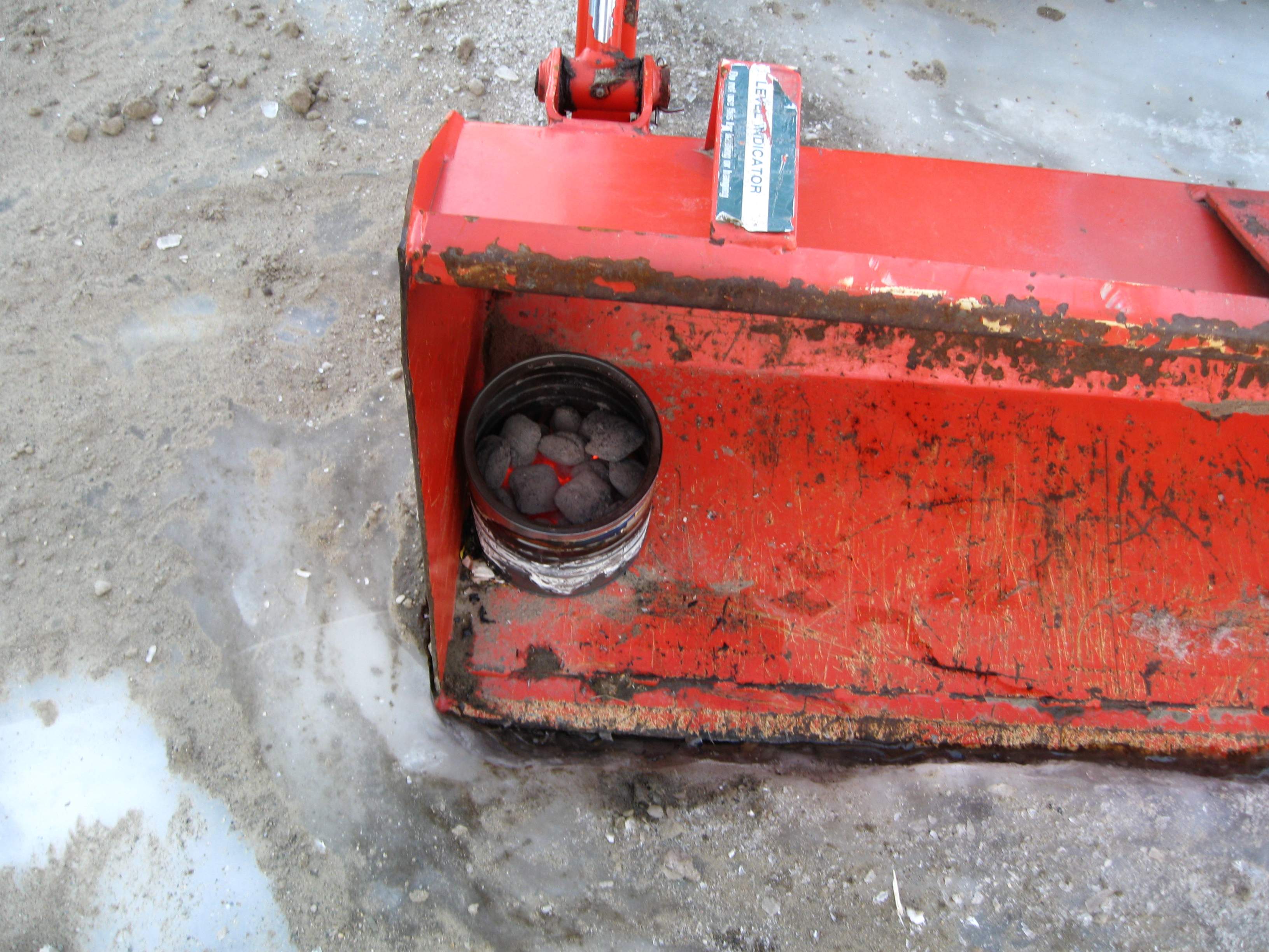

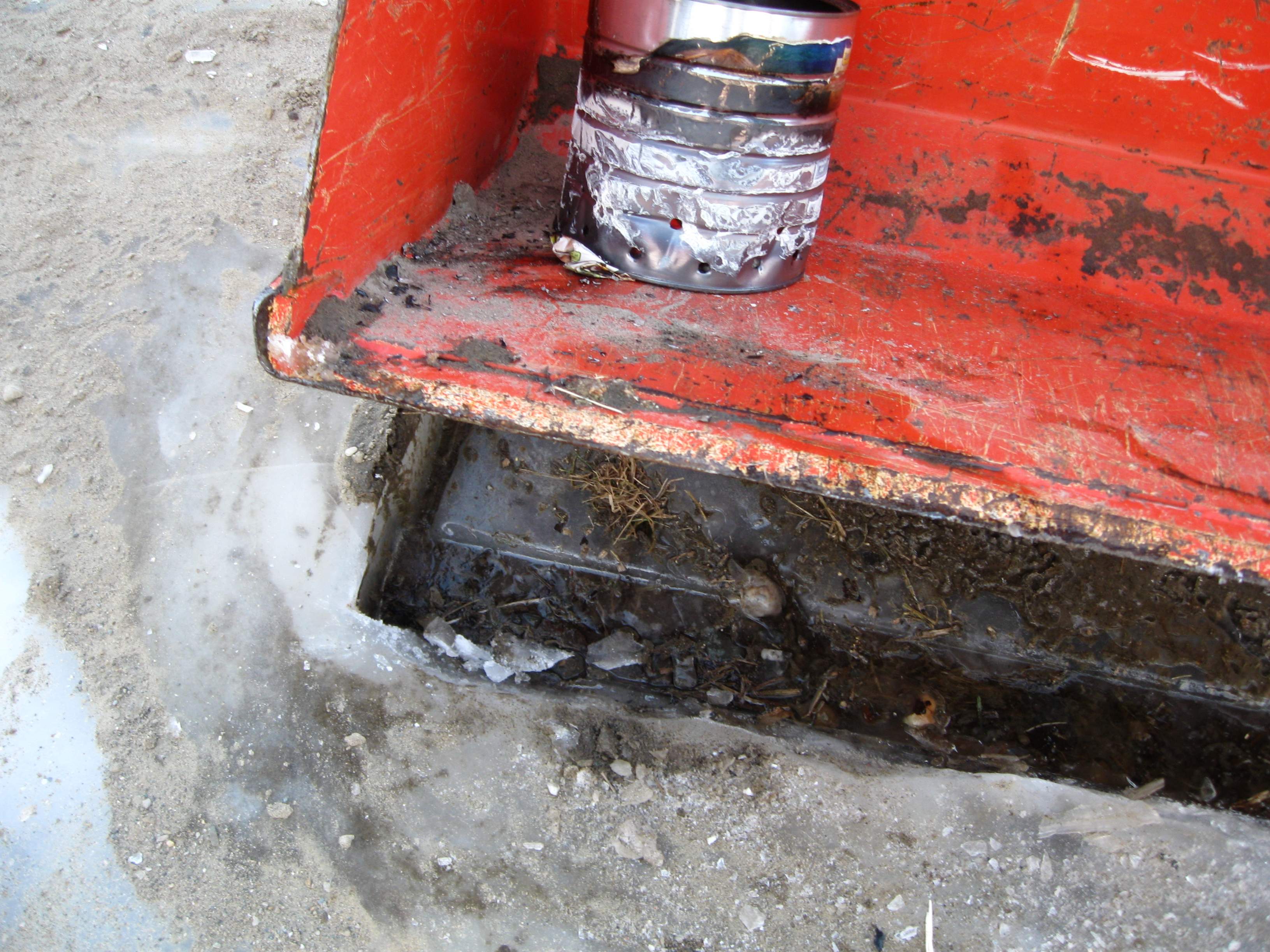

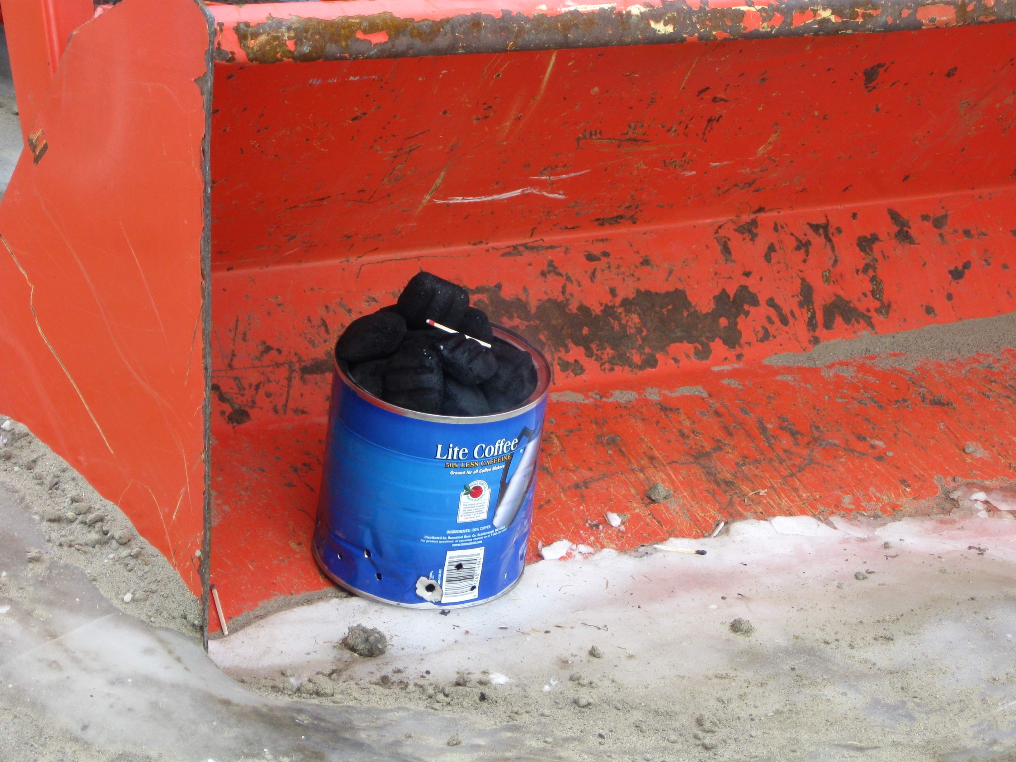

So, out came the charcoal briquettes and I made a 'chimney starter' out of a large metal coffee can. I thought this would do well to get the briquettes going. (1st 2 photos).
Once they were going well, I tucked the can against the side wall where the most ice was. It did not take long for the radiant heat to warm the bucket and surrounding area. I was then able to easily roll and lift the bucket out of the hole.:D (photo 3 and 4).
I did a rather good job of securing it in the ice as shown in the last 2 pictures:eek: Seeing how much was on the one side of the bucket might have made for some big problems if I hadn't thawed it first:rolleyes:
So then I asked myself.....what do i do with a load of glowing charcoal?:confused::D

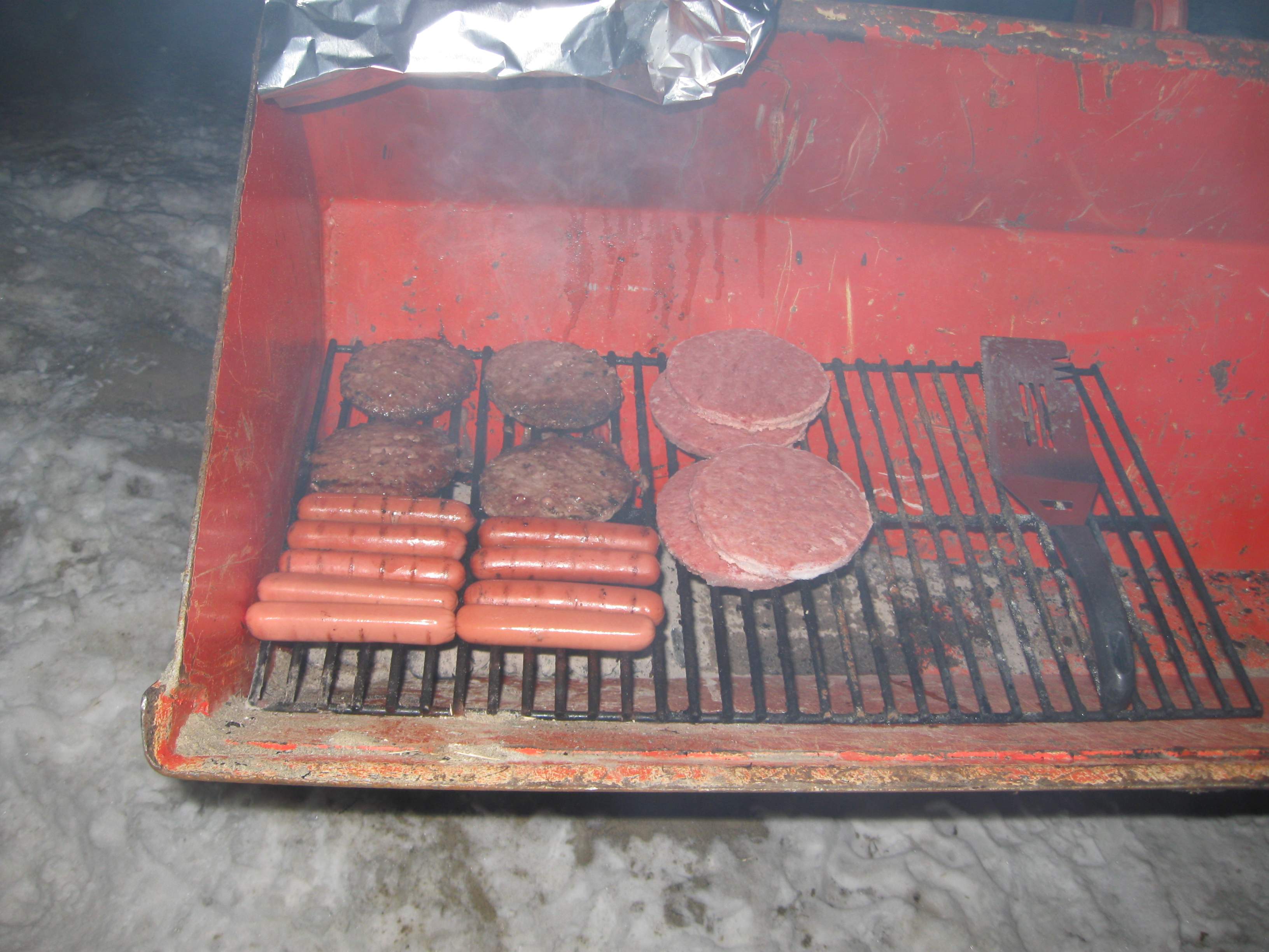

So...the wife usually complains that i spend more time on the tractor than I do cooking dinner:rolleyes: So I thought to myself, how can i achieve the best of both worlds.
Well today was that day. I already had the charcoal ready, the tractor was freed out of the ice so, I drove over to the garage and set up for a BBQ!:D
What better thing on a cold winter day than to enjoy some fresh, hot off the grill burgers and dogs! But in this case, I could fairly call them 'Bota Burgers and Tractor Dogs:D (my kids came up with the names)
Worked well, although a little slower than expected (didn't want a huge fire in the bucket) believe it or not, the paint is still intact:eek: -and for those who would ask, yes it is a clean bucket.....only been moving snow for a while now.
So, for your continued laughter, enjoy the pictures...I'll enjoy the burgers:cool:
