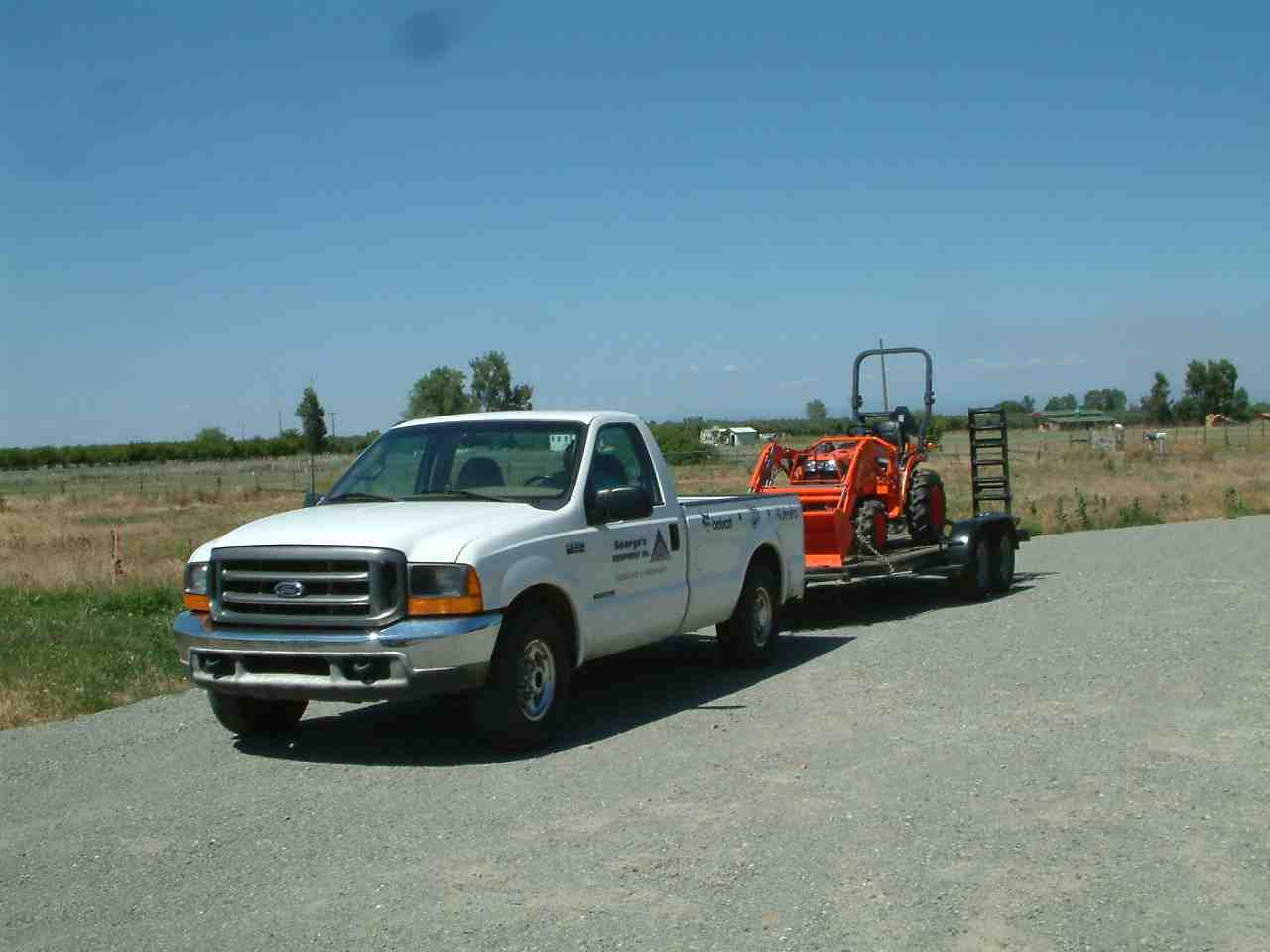

Here's what my Kubota dealer used to deliver my B7510HST with LA302 FEL last May. The tractor is 21HP and weights about 1900 lb with the FEL. That's a F250 and 16 ft twin-axle trailer.
IMHO, this is about the right setup for transporting your pride and joy regardless of how short the distance.
I have an F150 that can pull 7200 lb. If I need to haul the Bota, I'll rent a twin axle trailer from U-haul. Can't justify several thousand bucks for a new trailer since it would sit parked most of the time.
