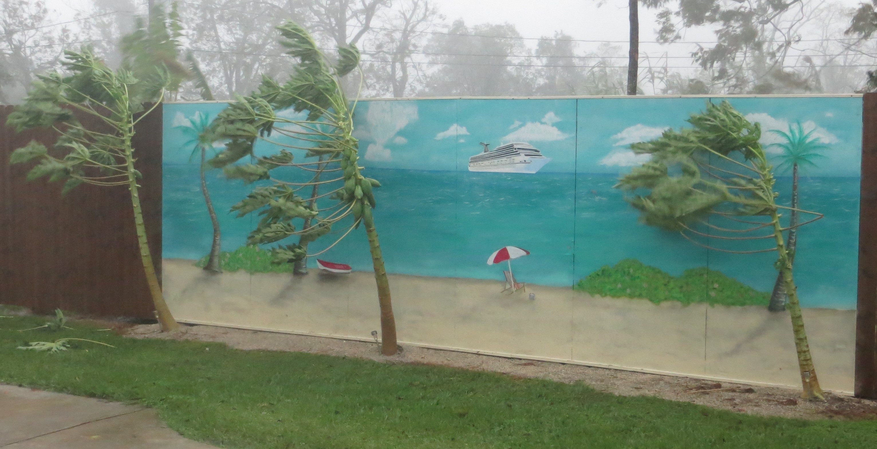

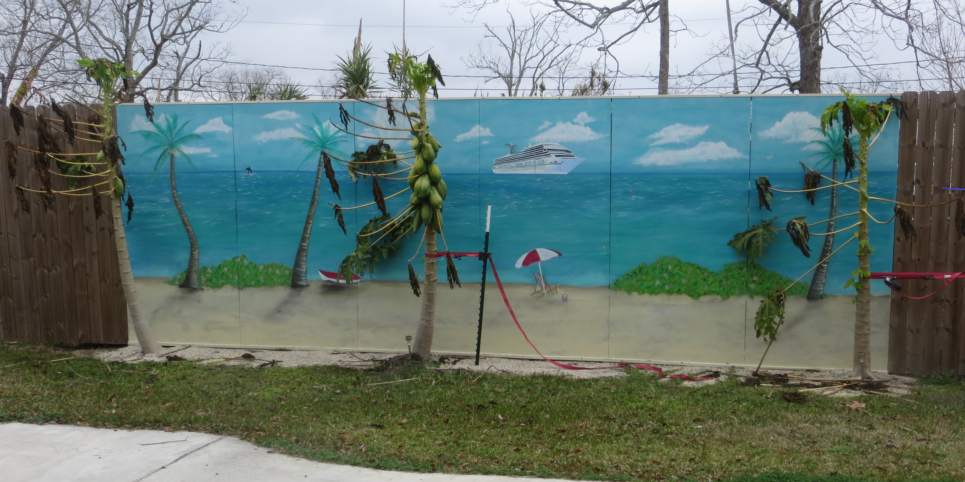

My poor 9 month old Papaya trees were so pretty before the last hurricane hit them a couple of months ago. They had most of the branches blown off and were leaning at 45 degrees. I'm hoping that they can make it through the rest of the winter and recover in spring.
Wow,it realy did a number on those trees,I hope you can save them. Look's like the :umbrella: made it through unscathed.
