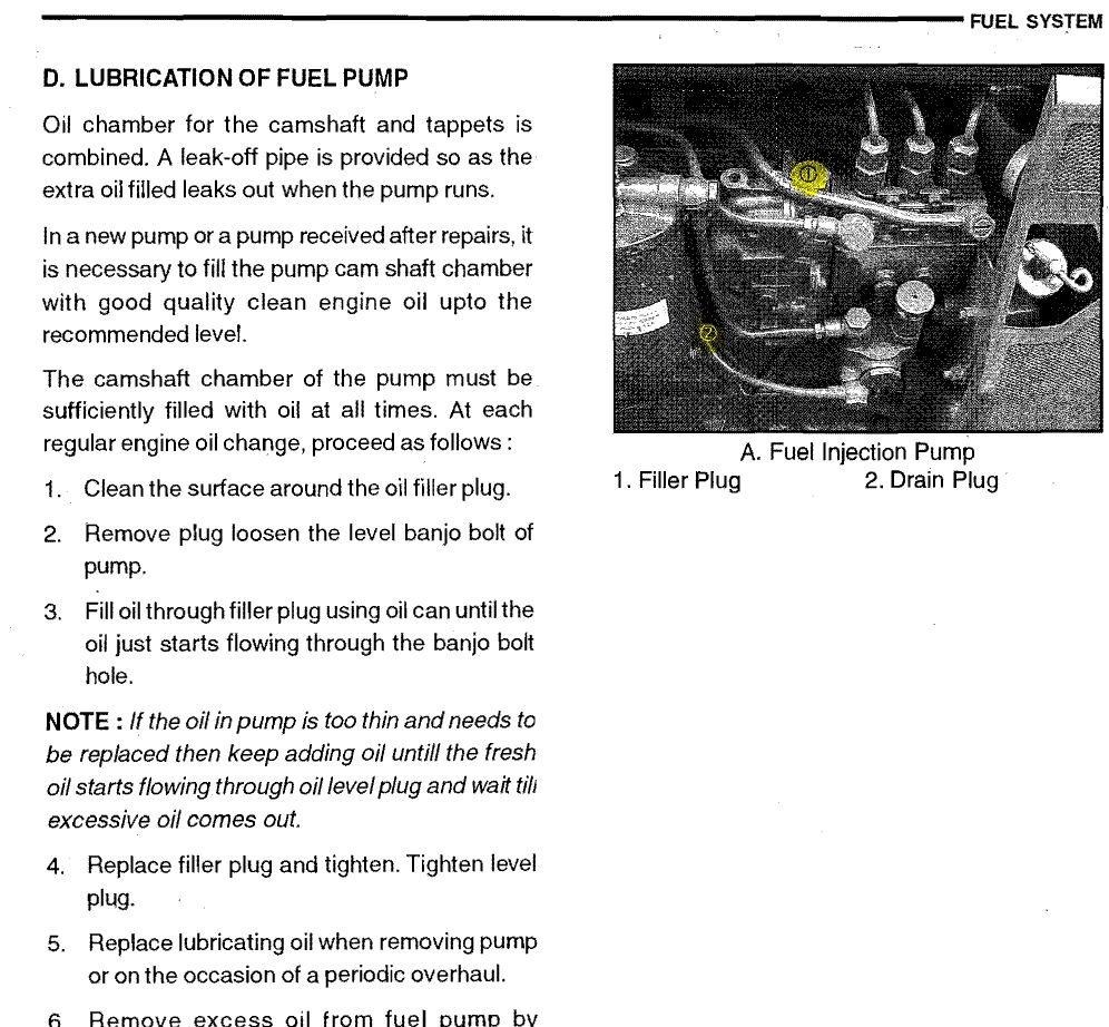

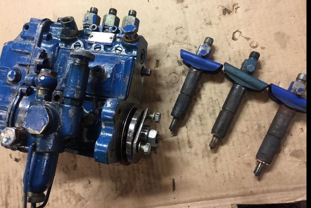

This is my problem: I have all the manuals but they are fuzzy on the oil fill and drain plugs (the operator manual shows a photo of the pump but they omitted identifying the fill and drain plug. It appears the fill plug is on top of the governor housing. the drain plug appears to be down below the inspection cover. The drawings in the parts manual are similar but different than my pump...the drawing seems to show a small dipstick. My pump looks similar this one that is currently listed on ebay. I'm going to take the photo out to the swamp to verify....don't tractors always break down in swamps or mud or some other awkward location.

Your pump shows up in my manual, but you're right the pictures are fuzzy.
Do you have this picture?
The picture in my operators manual just has a photo without the numbers. The pump in your picture shows a #2 overflow that is not on my pump, I think. I think for my tractors the level port is a little behind and to the right of the primer pump. Thank you. I did fill the thing up to the top using the filler port. There is a tube for overflow on my tractor. I watched the ATF flow out of it...I had thought the tube was a diesel vent of some sort in the past. I plugged the tube to allow the pump interior to soak in the ATF.

The drain plug is to the right & beside the lift pump..10mm wrench.
Taking the lift pump OFF will get MORE out tho.. BUT theres a paper gasket that will rip..
The "full" plug is on the back of the governor cover, at the bottom..10 or 12mm wrench

"Normally" you don't have to check an injection pump.. It just depends on the manufacturer..
IF the pump is "fuel oil" lubricated, a rotary pump, lines from the pump TO the injectors come off the pump in a circle.. they use the fuel to lube the internals..
IF the pump is an inline pump, the lines come off the pump in a straight line.. some are lubed by engine oil pressure FROM the engine & others are filled manually.. like yours..
& there are models of FarmTrac w/ Mico pumps that ARE lubed by the engine.. & they STILL rust.. its just a bad design..
