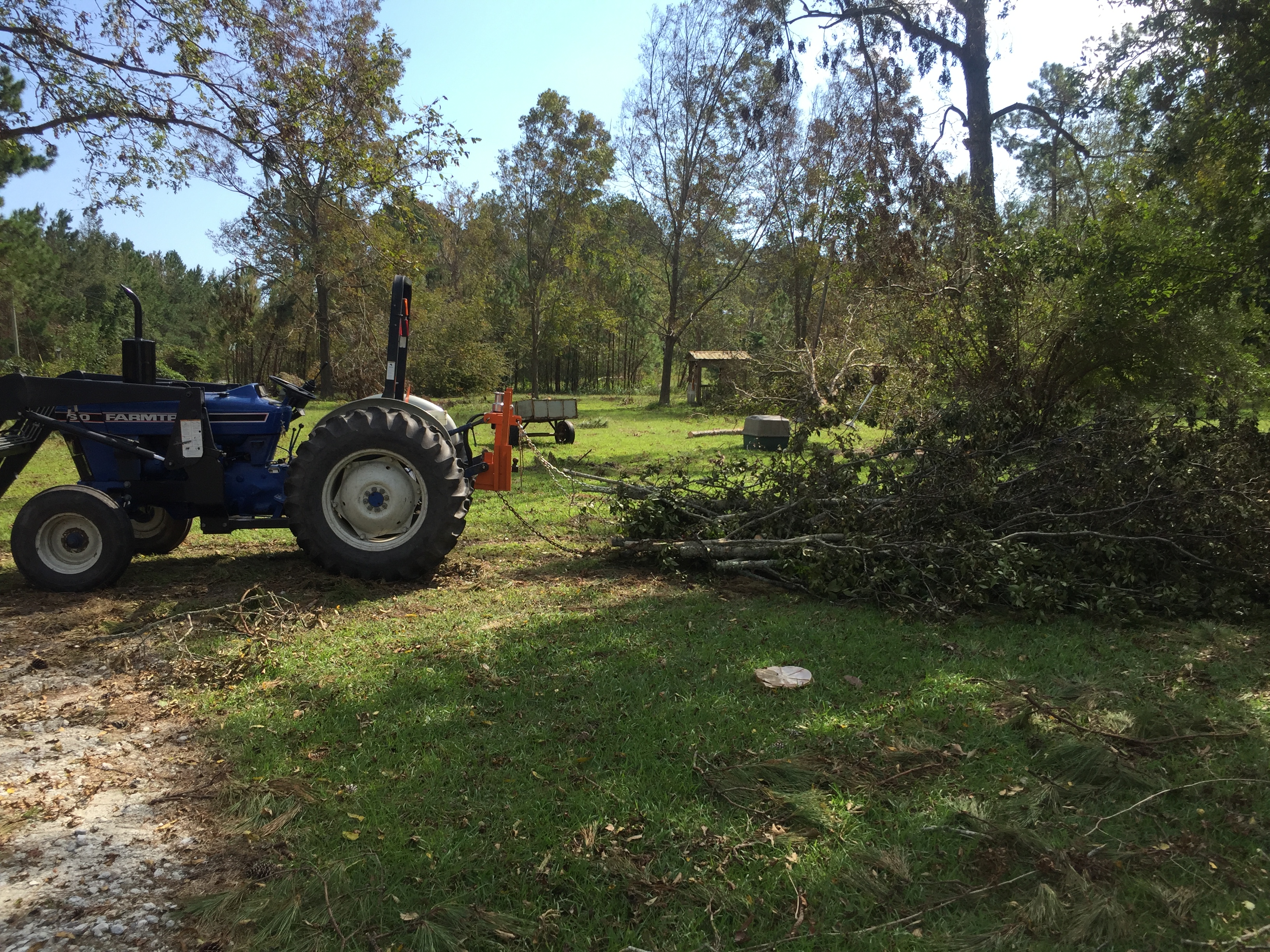

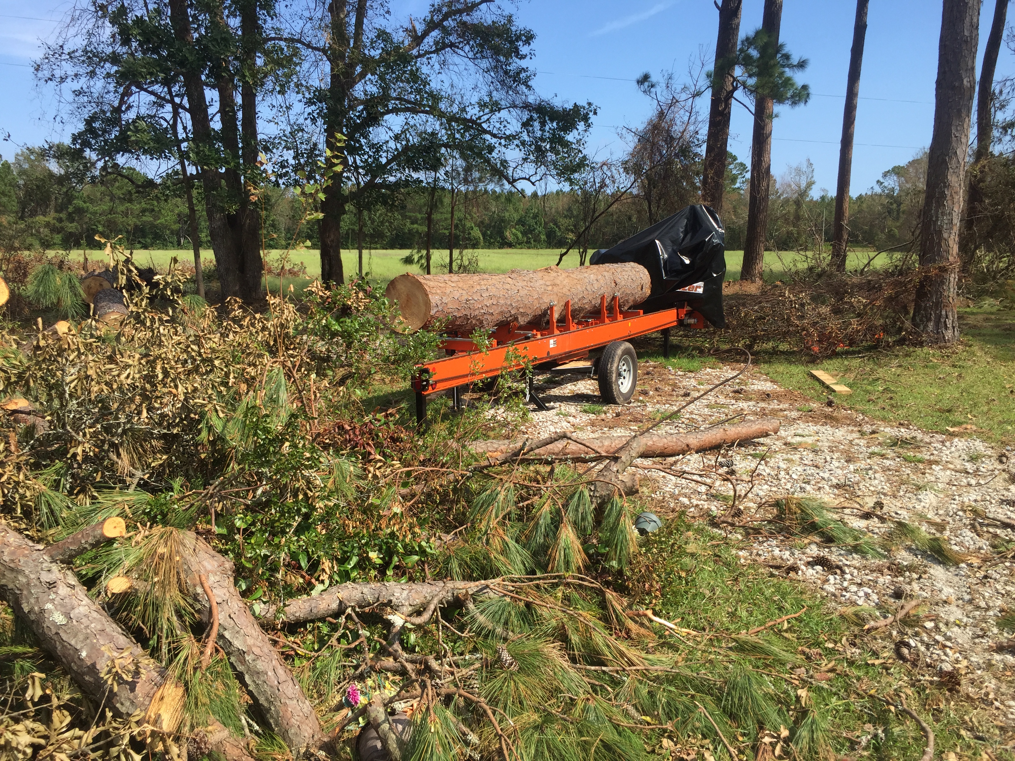

Tractor has done about 50 engine hours of hard work with the tractor since Florence hit. Hauling logs and brush. Tractor is still humming along. Changed the engine oil yesterday. Will drain and refill the fuel pump in the near term and replace the second fuel filter.
