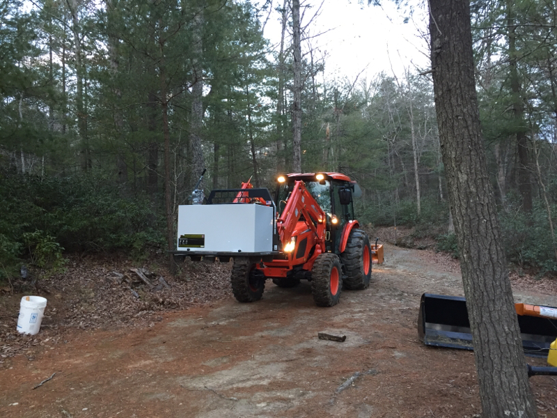

No, these are the full set of pallet forks with SSQD. Rated for 4400 lbs. I filled both the tractor and the excavator. It really wasn't bad at all. I was quite pleased with the pump. Here is a picture when we were taking it off the truck. BTW. This is the wife driving the tractor. Today was her first training day on the tractor. She has driven itn nce before about 4 or 5 months ago, when I first got it. Today she did some land clearing with the grapple and box blade and put on the pallet forks and unloaded the fuel tank. I was on the ground giving direction. She did great. I was quite impressed.
Guess you got all the kinks work out, and sounds like the pumping is easy and fun. I don't think my little L3400 would lift that tank.
