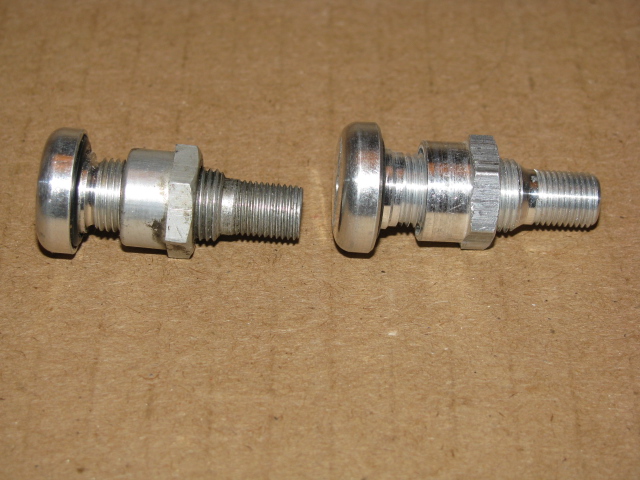

Artvlr - There are different grades of valve stems. I use the ones rated for high air pressure and they have held up for over 8 years so far. I also take and drill out the brass inside with an 1/8" bit after removing the valve core to allow for greater air venting. Early on I had used a cheap rubber one & like you it did not hold up very long.
The ones I use on my trailers are all metal, and short like these:
