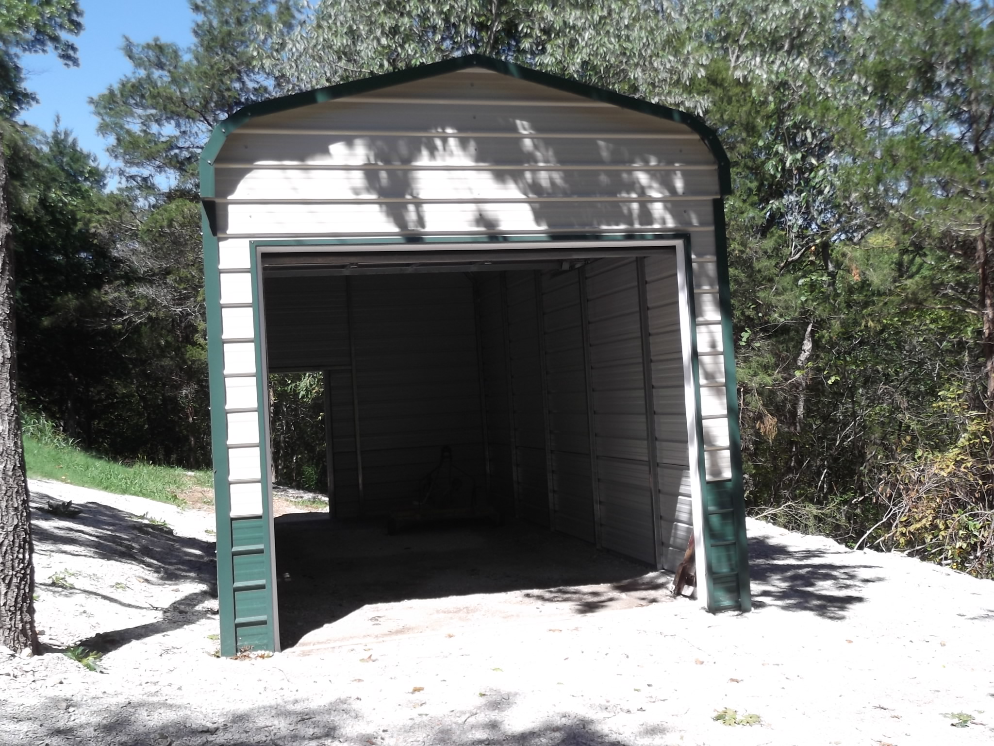

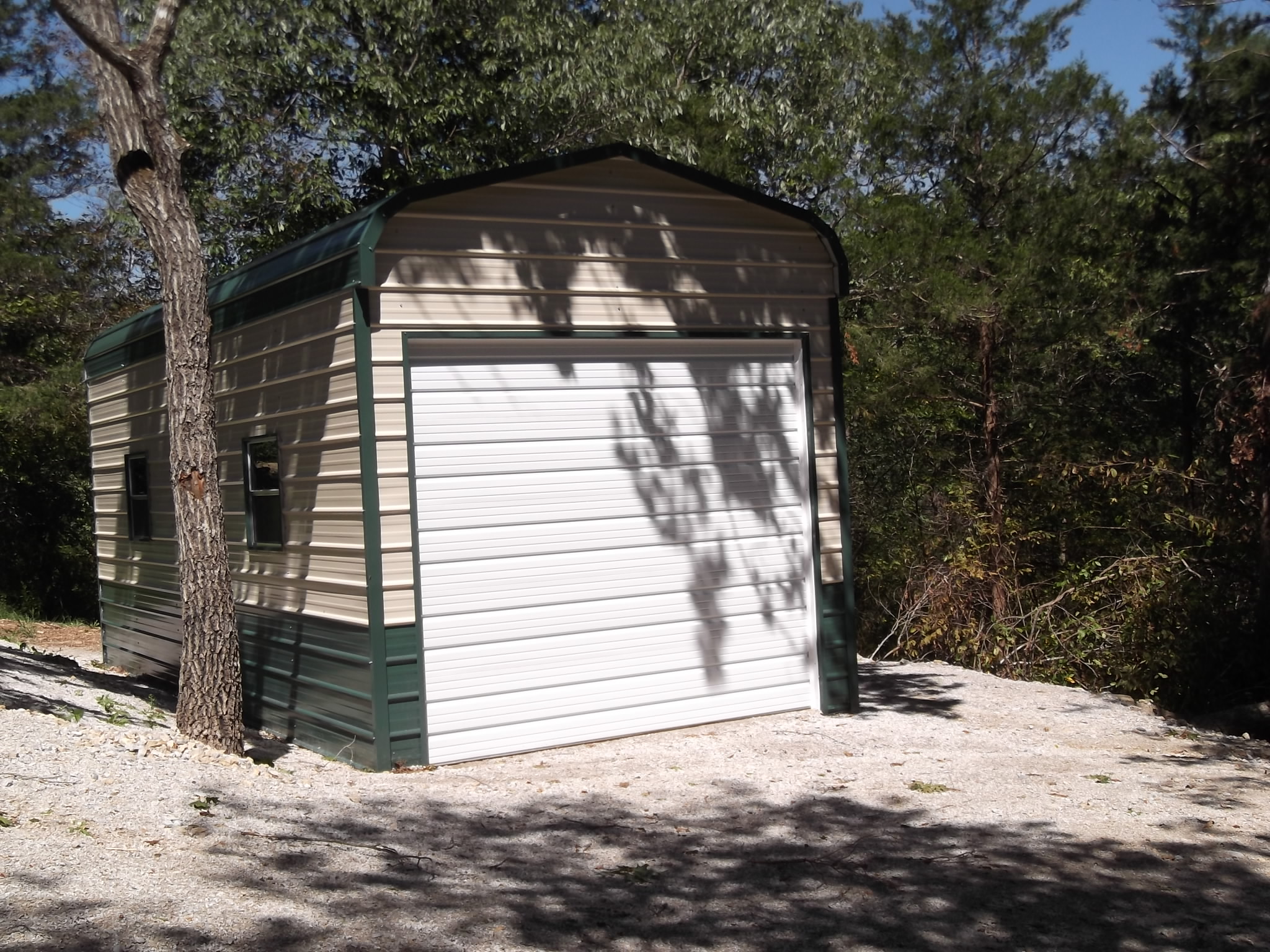

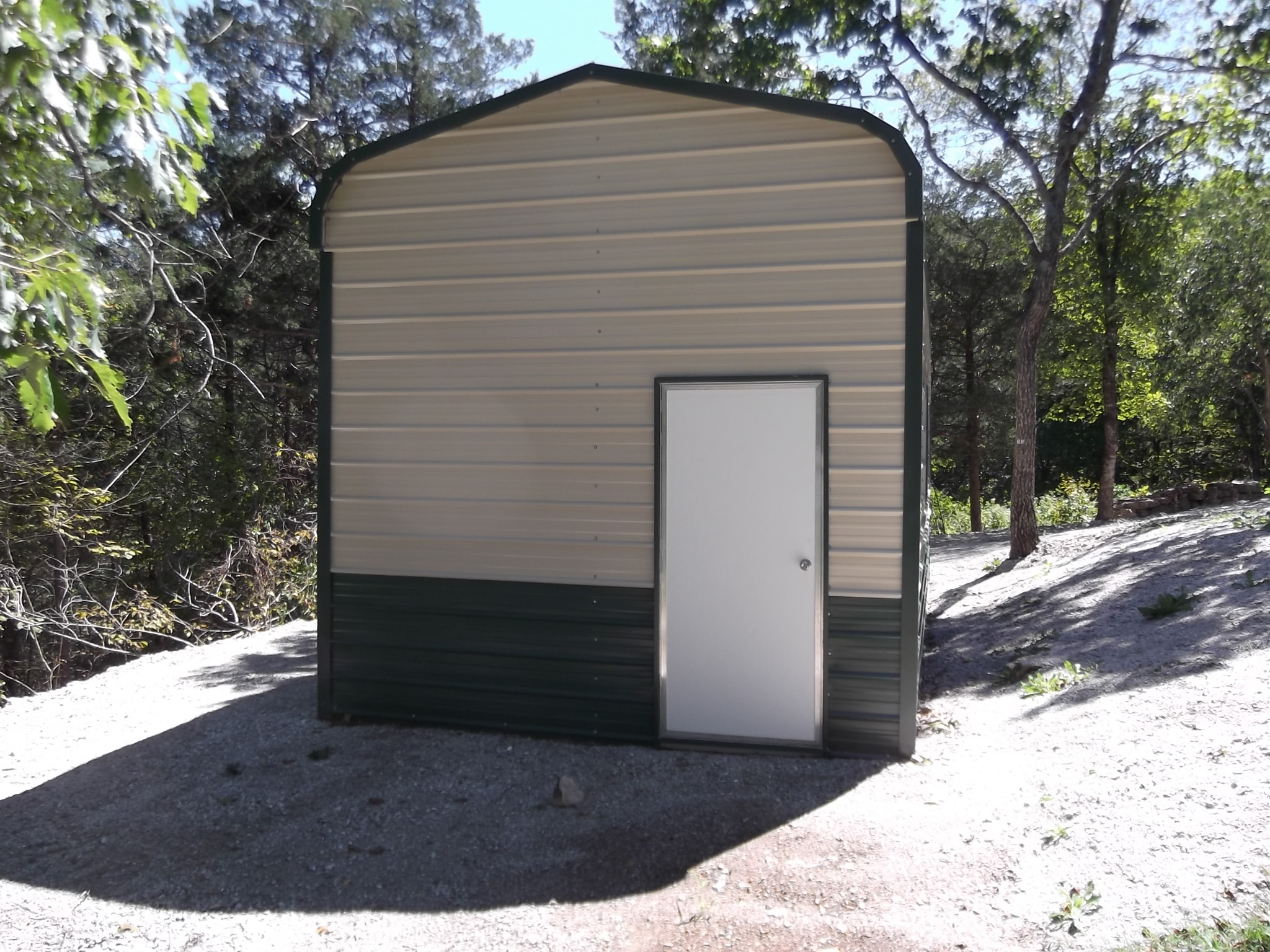

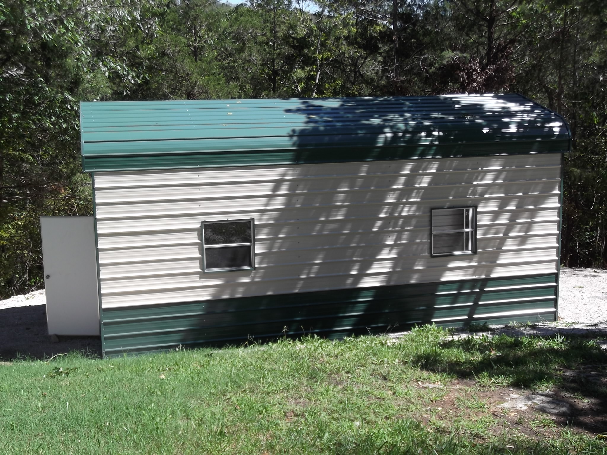

I had to wait a few months to get my Kioti Den built. I hated leaving the tractor out in the weather those few months. It takes a slow toll on everything.
