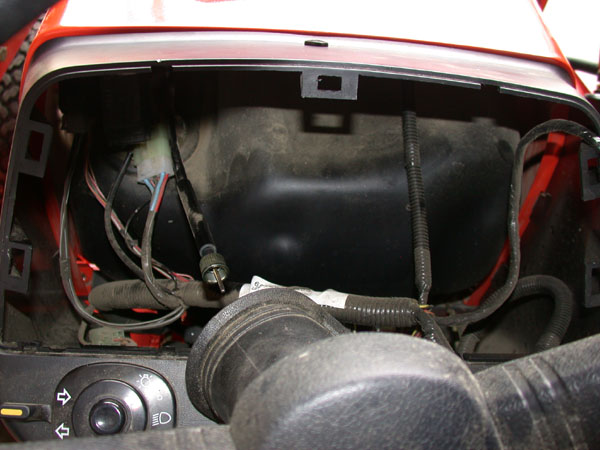

Attached is a picture of my fuel tank after carefully using air pressure to expand it back to it's original shape. It came back perfectly except for one very small dimple at the upper right.

You obviously have a plugged breather hole in the cap. use a straightened paper clip and clean it out. If you don't have a hole in the cap, your breather hose is pinched or has something in it. Find it, and either remove the kink or obstruction or replace it.

You need to read my first post that tells the complete story. If you look at the bottom of the B7500 fuel cap (I'm sure other models are the same) you will see a series of evenly spaced oval holes molded in the plastic at the outer circumference. These cavities are formed to go down in toward the center of the cap with the air connection coming through a small hole in the center of the rubber diaphram. This cap was brand new and could not have gotten clogged up in the short time I used the tractor. It is not designed to be cleaned with a paper clip. One would have to wash it and use air pressure to clean it. But this cap was just a bad mold. That was confirmed by the dealer.
