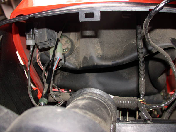

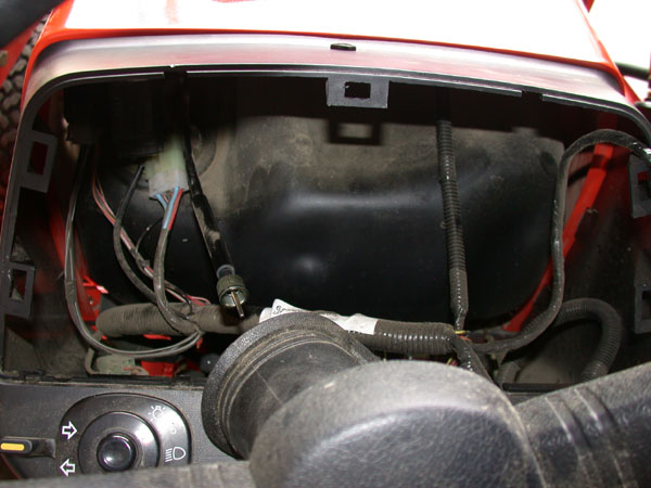

I'm not sure what fuel cap you have but it may be the same as the one on my B7500. There are little rectangular vent holes all around the outside of the cap. I bought mine new 4 years ago. Never having owned a diesel powered anything before all I knew was that they were more efficient. After cutting grass a couple of times and not seeing the fuel guage move much I became suspicious. Shortly after the engine started to loose power. I opened the cap but could not see the fuel level because of the neck design. I do remember a slight whoosh or air but the old brain cells didn't trigger on that clue. Everything was OK but only for a while. It turned out that the original cap was not venting and as fuel was being used the vacuum was sucking in the 5 gallon plastic tank to the point where the fuel guage pickup was "stuck" in a relatively high position. I took the cap to my dealer along with pictures of the collapsed tank and he promptly gave me a replacement cap. I would have had the dealer replace the tank but I figured that would take several weeks and I didn't want my new baby gone that long. So I very, very carefully applied low air pressure to the input fuel line which popped the tank back into original shape. I, of course, had to do this with the faulty cap before I turned it in. Here are before and after pics. Bottom line is that, although rare, vented caps can be faulty or fail and getting dirty.
